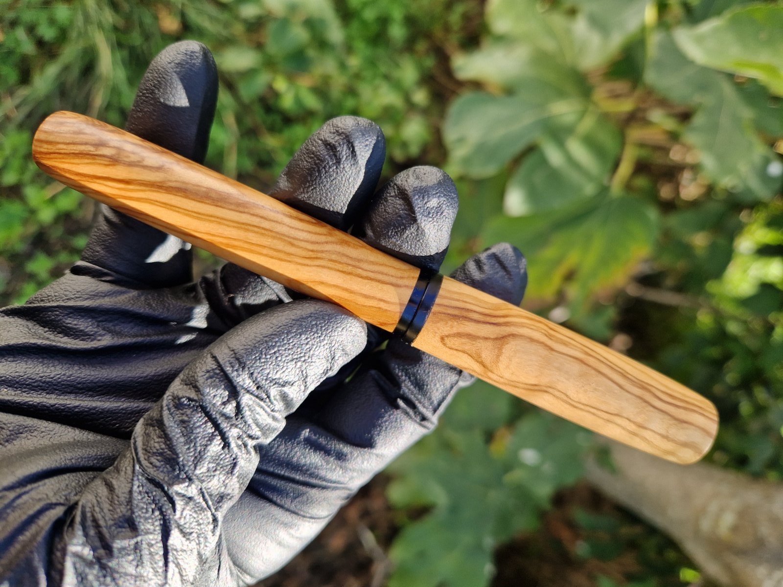

I am trying for the first time boiled lineseed oil as a finish for a wooden pen i made. I already applied 3 coats after sanding up to 1000 grit. My goal is to apply about 5 coats and then buff it ( maybe with some wax). Has anyone tried that before? I want to switch from pens plus and walnut oil to blo since it cures harder. Here is the pen so far, cheers

Looks good. I don't use BLO as a top coat because it has super duper long cure times and doesn't really build a film. If I'm looking for an oil finish that won't have a topcoat on it, I use Danish oil since it tends to end up glossier (I think it has some varnish in it or something).
Yes danish oil is a mix containing some varnish and thiners. I don't know if this experiment will lead me anywhere since olivewood is not neither that hard or oily like cocobolo for instance. Its my first kitless pen and i didnt want to risk my good wood blanks. Anyway the good thing with this clipless pen is that i can re finish it anytime i want to.
