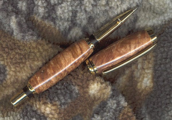

I just finished making a big leaf maple burl Baron in titanium gold. The wood was stabilized by River Ridge. In the process, I destroyed my nerves. I had previously blown out two blanks of this wood. As most people know, burls are delicate and can come apart if you look at them cross-eyed. Using a light touch, I spent an hour turning this and didn't breath the whole time. If we kept whiskey in the house I would be drinking from the bottle right now. My finish was my usual Mylands sanding sealer, then a rub with the length of the barrel using wool to eliminate finish rings, Myland's cellulose, more rub, then Myland's melamine, more rub, two coats of Johnson's paste wax and more rub, this time with soft paper towel. From six inches away the finish is beautiful. But, still, dang it :( up close one can see very fine finish rings. My creativity level is not like Eagle and others, I'm pretty much an inside-the-box type without artistic abilities. So, I'm not posting a picture for fear of (again) seeing the disparaging comment about those who just turn "bushing to bushing". If I can brag, the pen is beautiful. I might keep for a personal. Dunno, might put in my new display case and try to sell for a good price, like $60.00.

O.K., I should have known there would be a clamoring for a picture. Deny a child, even us grown-up ones, something and they want it even more. Thanks all for asking. Here is my lowly "bushing to bushing" stabilized big leaf maple burl Baron. Note the dot on the uppor portion of the pen barrel, that is a natural inclusion.

That's a beautiful pen! I love the wood that you used. The picture doesn't show the finish rings that you mention. I doubt most people wouldn't even see them if you didn't say anything.
As for the "bushing to bushing" turning, I do the same thing. I'll do a slight curve like you have on your pen the pic, but not much else.
Nice work!

That is a gorgous pen!

Contrary to your first post in this thread, Frank, that is a beautiful pen and the finish looks excellent. If there are flaws, they are the type that only the maker sees. I'm glad you were badgered into showing this beauty off!
