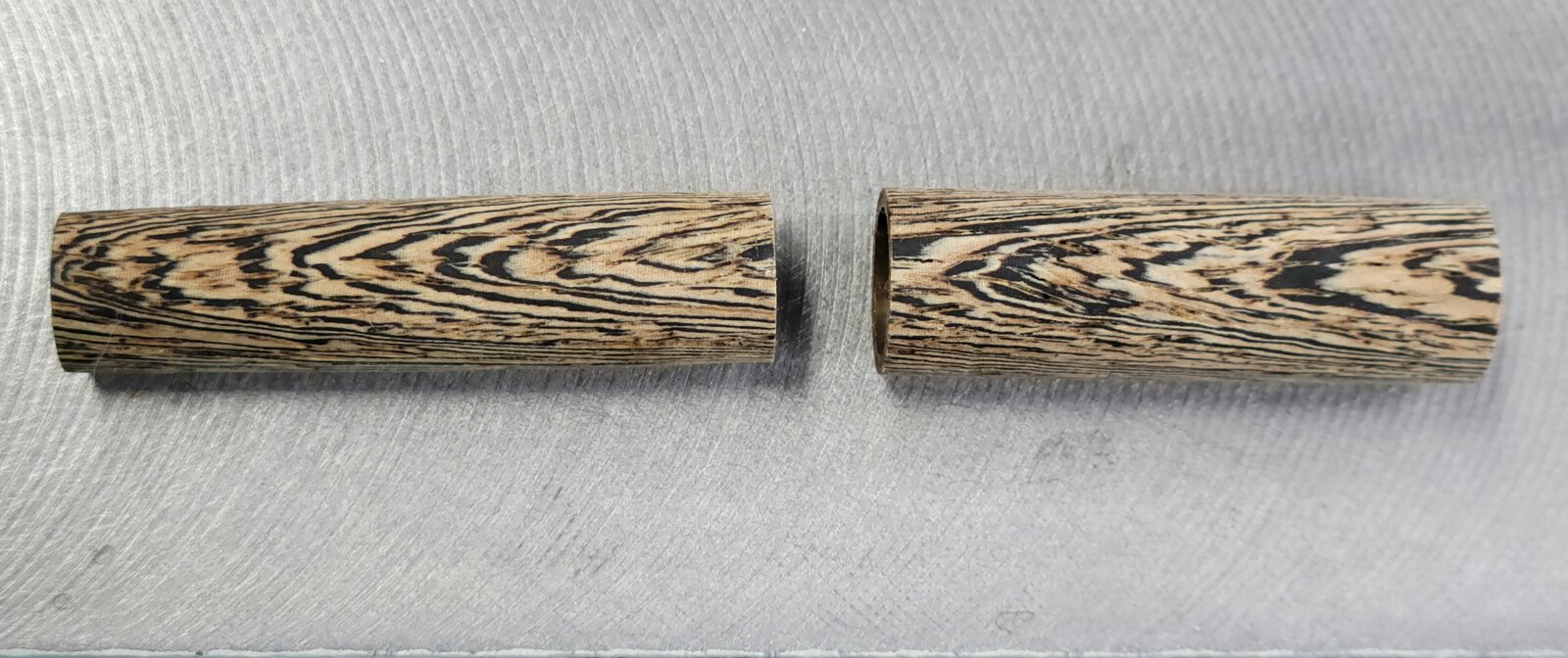

I have a couple of wenge barrels that I have turned almost to size and want to try the bleaching trick. Really, I only want to lighten it enough that the difference in grain colors won't disappear when I put finish on it. I expect it will take some experimentation to see what works for me, but I have some basic questions of those who have done this.
  • Do you use bleach at 100% strength? If not, what ratio are you using? (assuming it's mixed only with water as bleach does not play nice with almost anything else.)
  • The moisture must make the wood swell some. What experience have you had with this? I would guess it needs to be turned down again after it dries?
  • Should it be rinsed after bleaching? How long does it take for the smell to dissipate?
  • Is there any reaction with CA after it's fully dried?

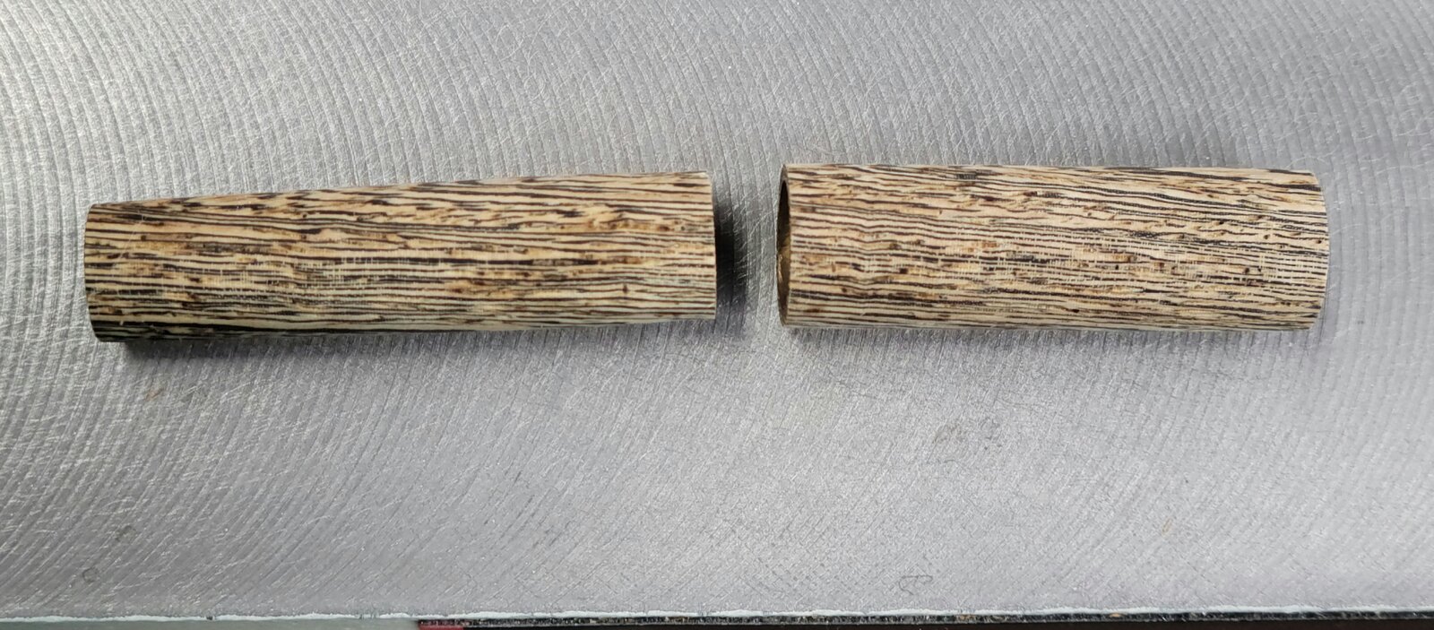

Wow, that got lighter than I really wanted it in just around 2 hours. I'll need to watch it closely next time.
