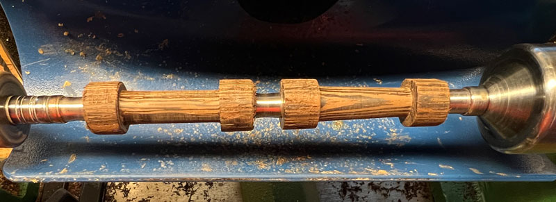

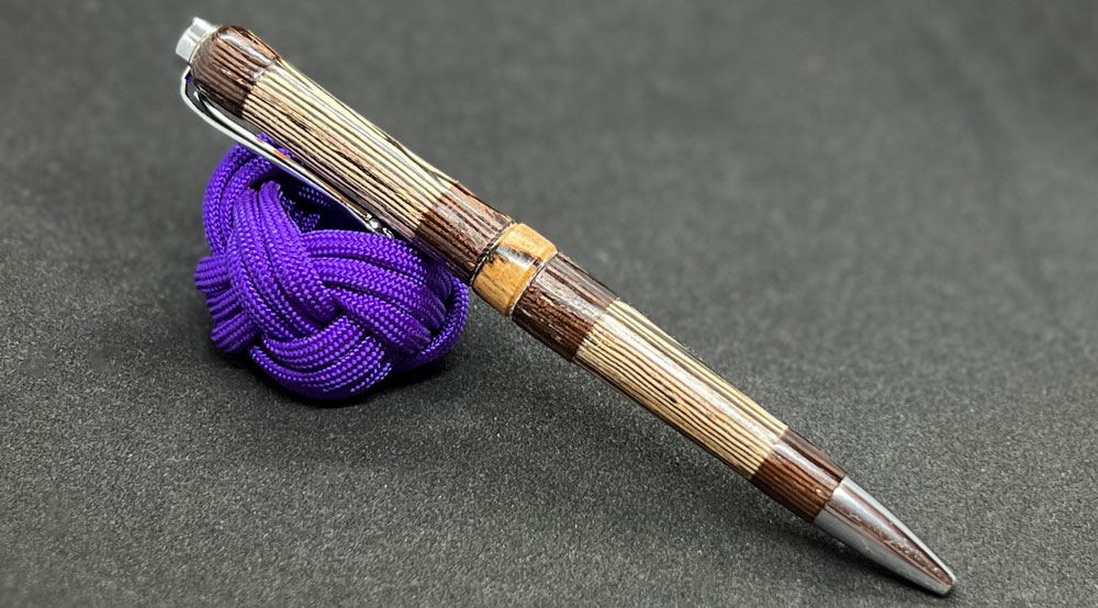

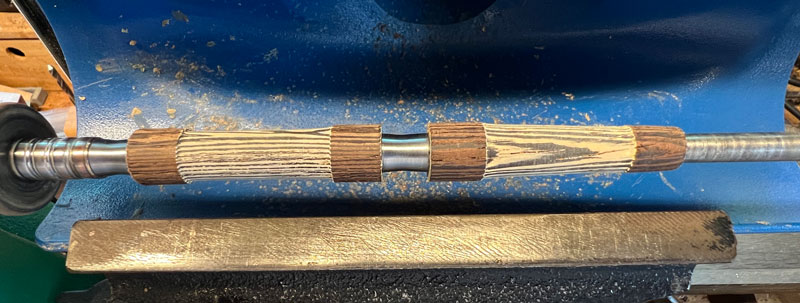

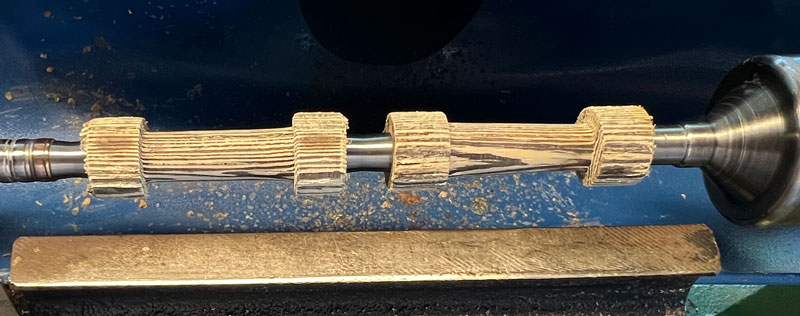

After watching @mg_dreyer 's excellent video on bleaching wenge, I watched the one he did on segmenting with guest appearance by @mark james . It's always a pleasure to learn from the best.
Anyway, the two topics swirled in my mind and I wondered if I could bleach in sections, giving it a "segmented" look without actually segmenting.
There must be 50 ways to achieve this effect.
This is the one I thought of...
Bleached "spool-shaped blanks" for about 2 hours and let air dry for about 18 hours.
Thanks for looking
- Cullen

Cullen, the original bleached wenge that I remember on this forum, way back before the first update of the forum (that I can remember) . . . there was a photo in which the brown was brown but the bleached was very much like the bleached section in your top photo. It was stunning. I have been waiting a long time to see such contrast. Thanks!

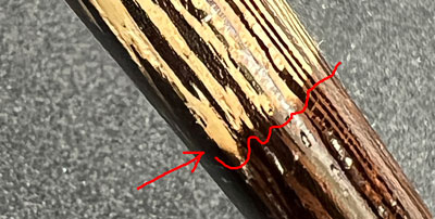

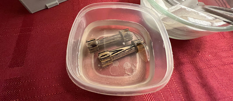

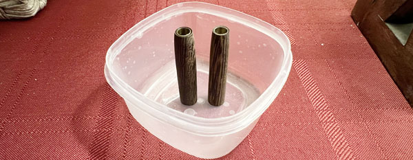

@SabertoothBunny - the clean lines impressed me too. I wasn't sure if that would happen. For instance, I tried another approach at the same time. I stood two wenge blanks in bleach. Somewhat predictably, the bleach followed some of the grain up creating not as clean of an edge.
I don't mind it... but it's interesting.
It reminds me that trees are supposed to move liquid along the grain.
But I'm curious what other ways I could limit the effects of bleach to certain places.

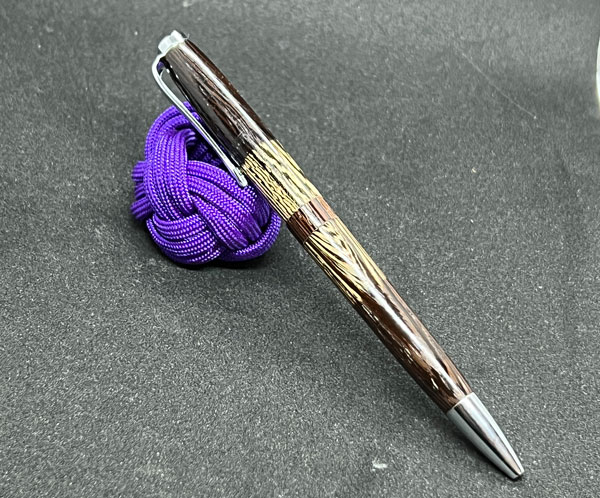

I like this one too. I think the blurred line of the color change is more like a blend than a crisp divider.
