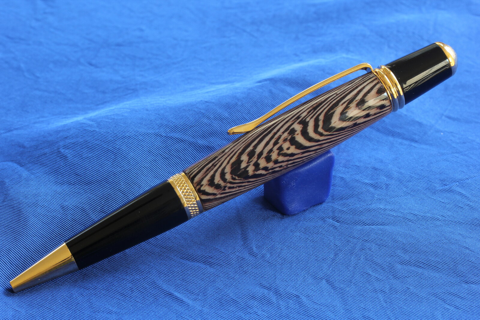

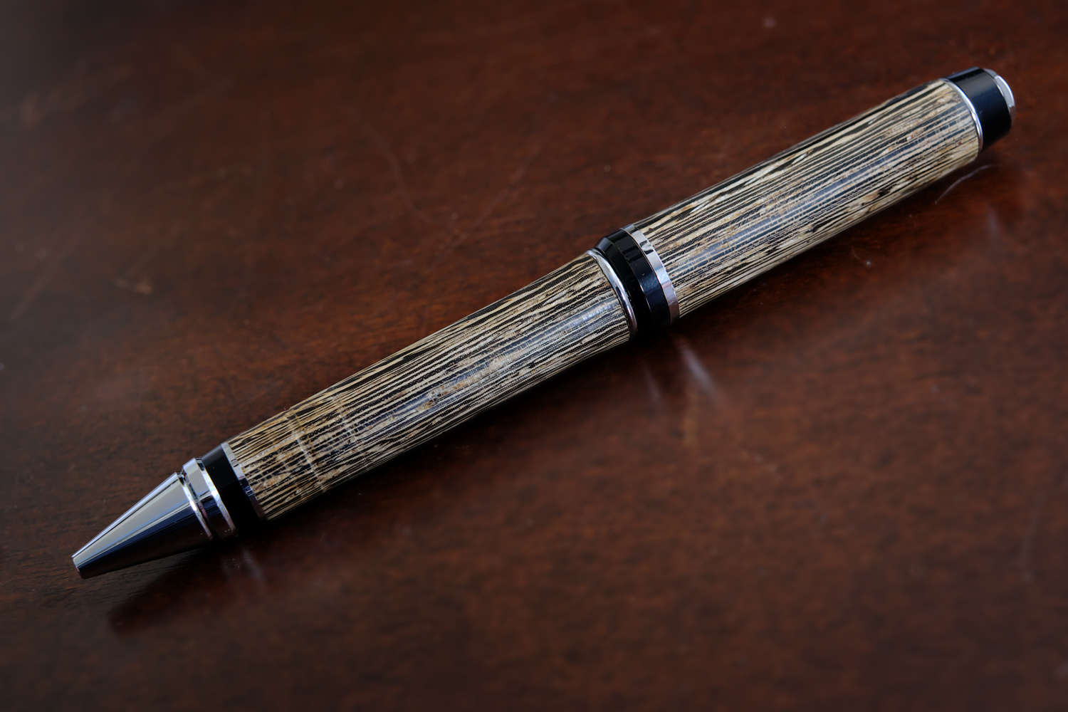

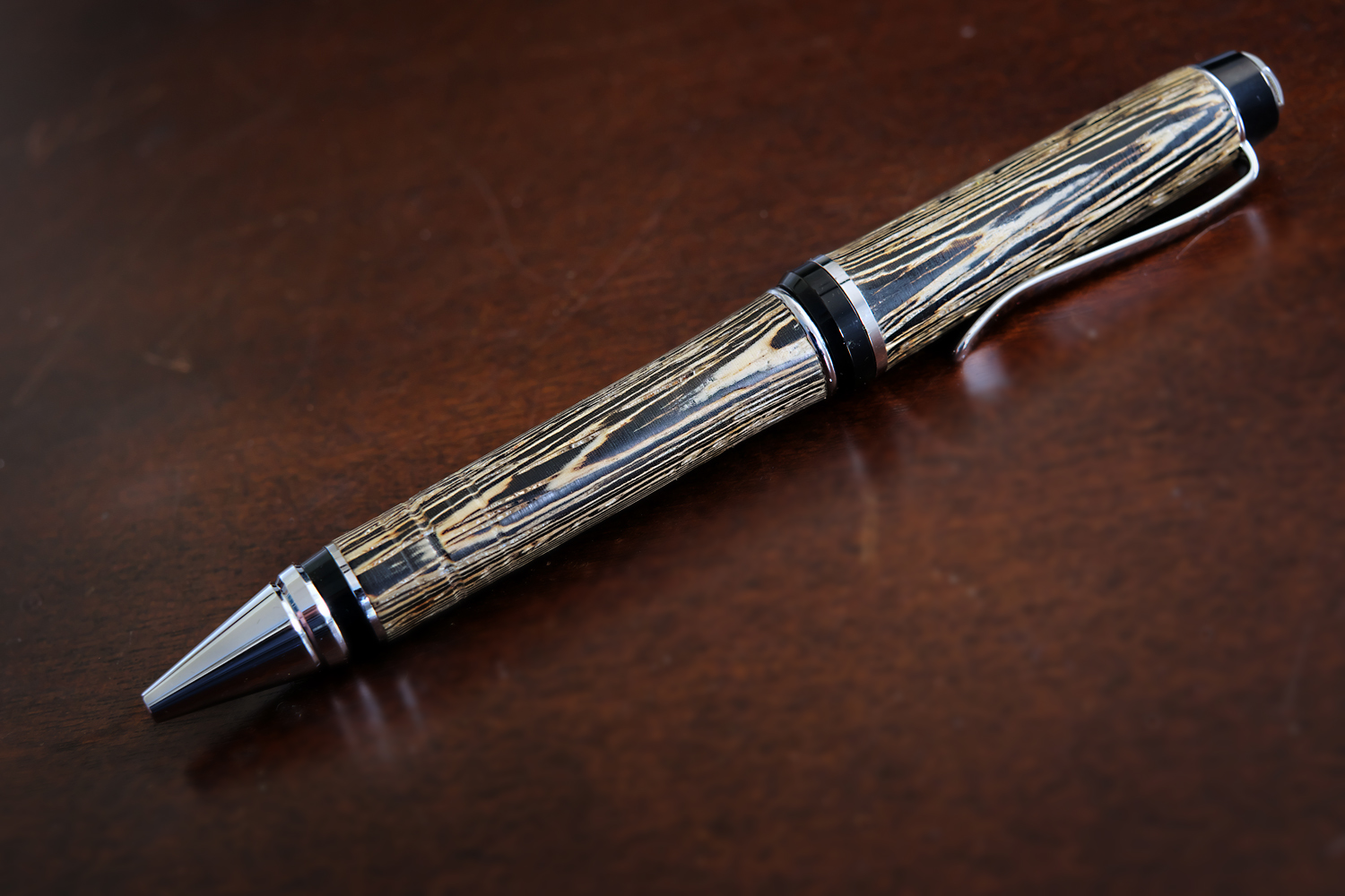

My Friend Jim gave me a piece of Weng because he was not too excited about the contrast of the grain...he thought it was a little dull and uneventful. I had seen many threads here on bleaching Weng to bring out some character so I decided to try it out last weekend...this is what I ended up with.
I've only been turning for about a half a year now so it's nowhere near perfect but I've enjoyed the journey and creative inspiration from this forum. Thanks to everyone that posts more regularly than I do. You're an inspiration to us all

Nice coloration. So I assume you turn it to dimension, then bleach, then sand or scrape to be ready for finish. Is it wipe-on gel bleach, or liquid dip?
Yeah, turned it down and sanded to about 400grit I believe. Soaked it in standard Clorox Bleach you can buy at any department store in the laundry isle. After about 3 hours of soaking I took it out and let it sit overnight. It had a slight greenish tint to it after sitting overnight but I put it back on the lathe and ran it through some light passes of 400, 600, 1200 grits (I think) and any tinting was gone. Finished with Pens Plus.

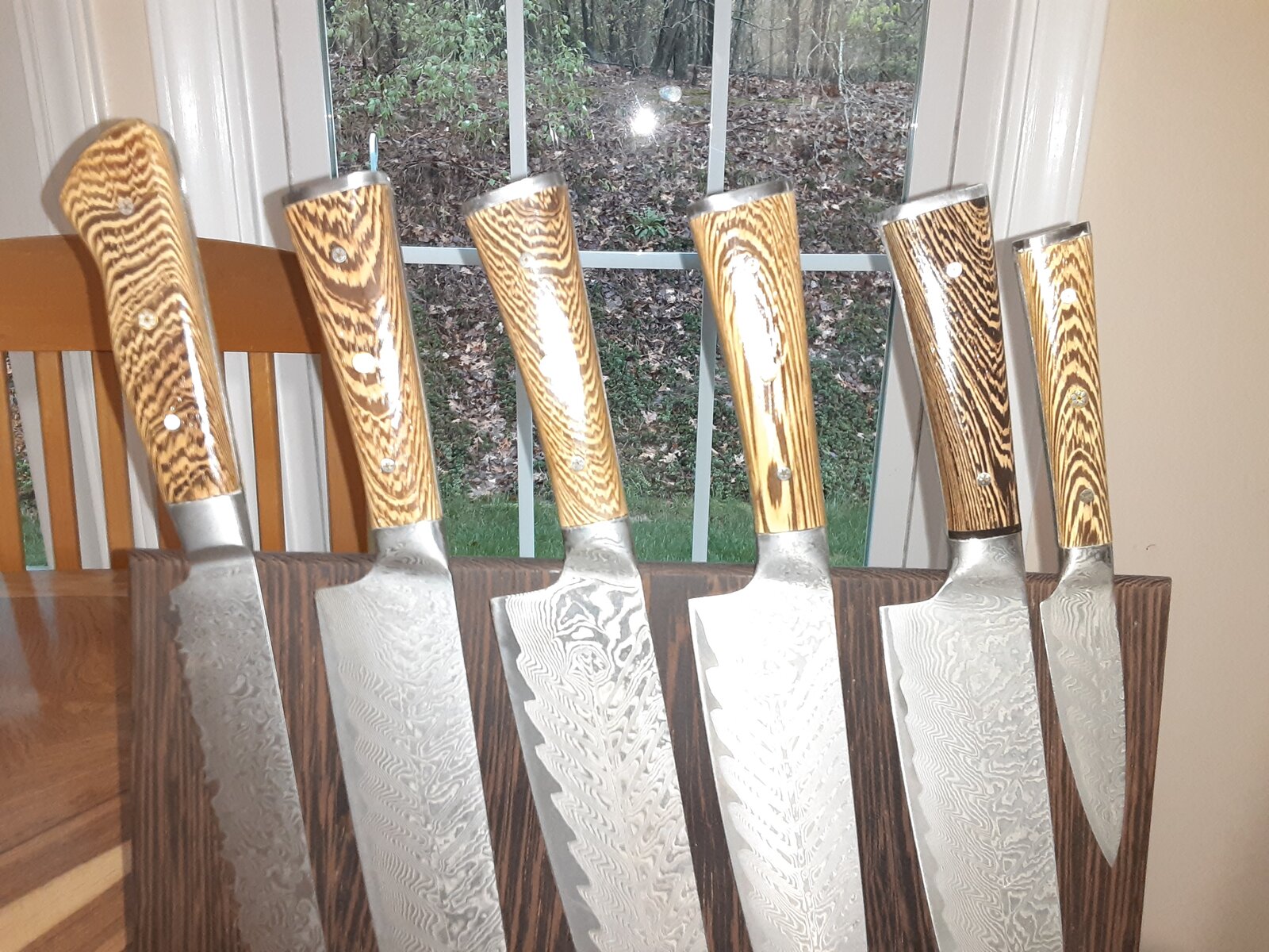

I have been bleaching wenge for years, never tried clorox. There is a product called wood bleach, and it comes in two parts. In the knife photo, one has had one application of bleach. All the others have two. the stand is not bleached. I seem to remember (again long ago) a discussion of using Clorox versus this product, might well have been propaganda to convice me not to try clorox. This product recommends 10 minutes for part A, and part B is a neutralizer.

View attachment 351561View attachment 351562View attachment 351563
Those look fantastic. I was a little concerned on the household bleach front - mainly because I was unsure how it would react with the brass tubes. I'm thinking prolonged exposure would erode the brass but soaking for a few hours would not be too corrosive.
