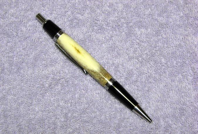

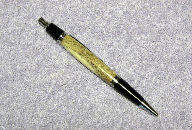

I finally got a chance to try a piece of elk antler I received a while back in a blank swap with Landon (hunter-27) in Nebraska. I put it on a Sierra click I had to rebuild after the original blank I used cracked. Once new tubes became available from Berea, I decided to try the elk on it. It was very porous and required a lot of soaking with CA (and sanding)to get the marrow filled, but I really like the way the elk antler looks. I think the next piece will go on a nicer kit. Thanks Landon.
Comments of all kinds welcome.

Beautiful pen. Nice job on the finish.
I just turned a bullet pen using elk. It had the dark marrow and the white "ivory" part was marbled with pink. I can't get the pink to show up good in a picture, but it is really nice. I like elk better then deer.

Nice work! I think you should have an elk or elk antler engraved on the white oval. I agree with PaulDoug, I like elk over whitetail antler any day. Most elk I have turned has had a deep maroon marrow, but they were from tine tips that were not very thick.
JohnU
Jan 31, 2008
4,973
Ottawa, Illinois
Ive turned and cut lots of each and found a difference in the marrow between the two. I dont know if its because of the differences in foods consumed, their environments, or just dna in how they grow to shape (with elk being thicker and longer). Ive found whitetail to have a small pocket marrow, where elk seem to be more of a longer sliver type grain (with more marrow and less outter white surface). I would agree that color is just chance in each, but I havent seen whitetail as dark as I have elk.
