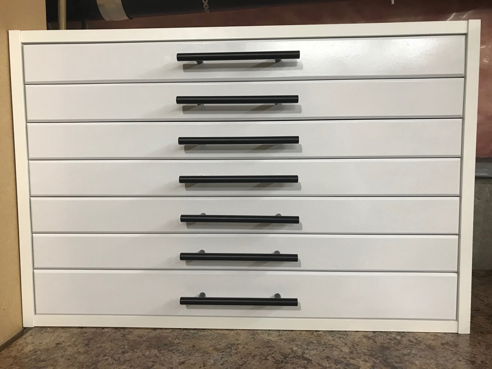

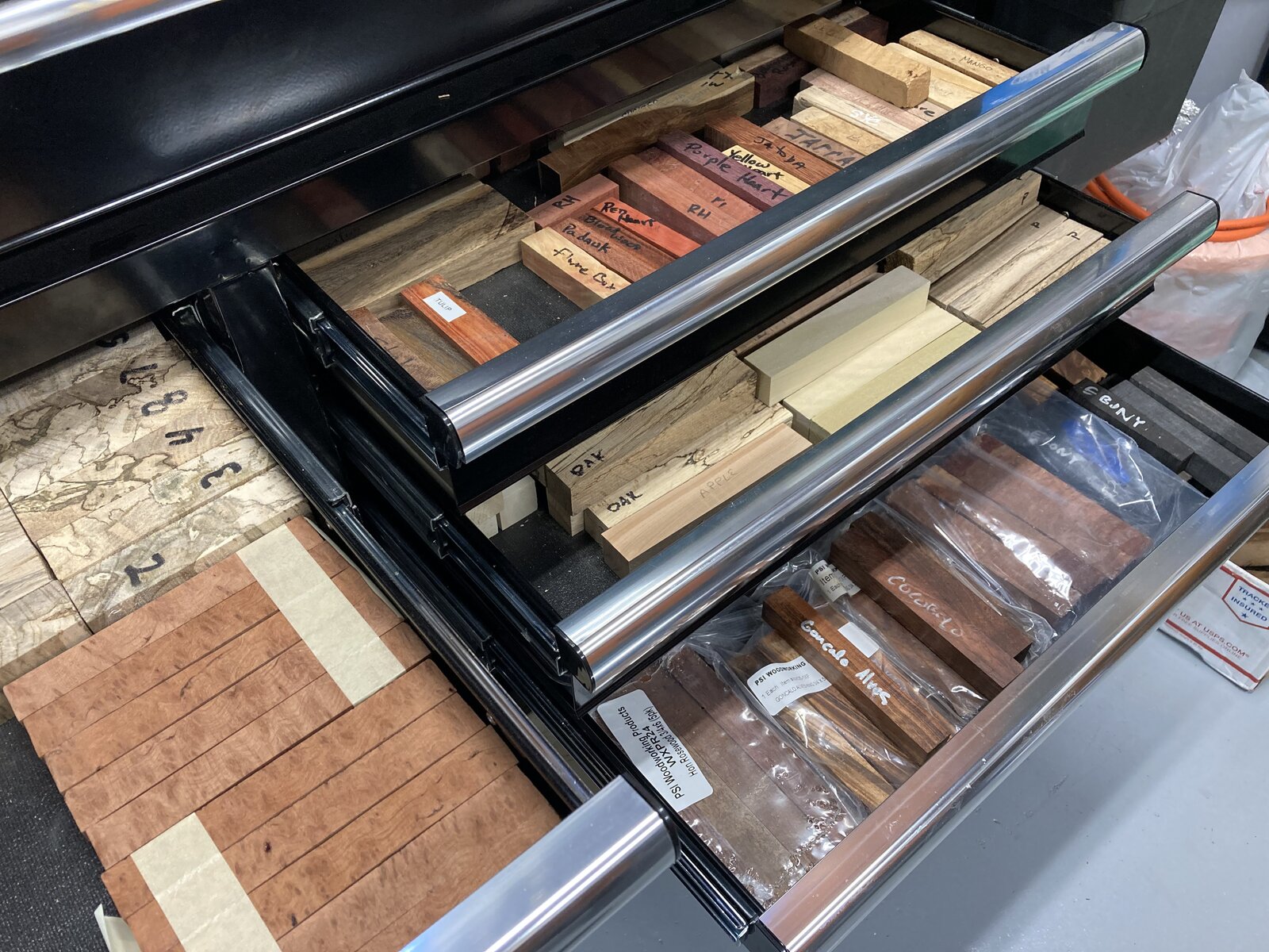

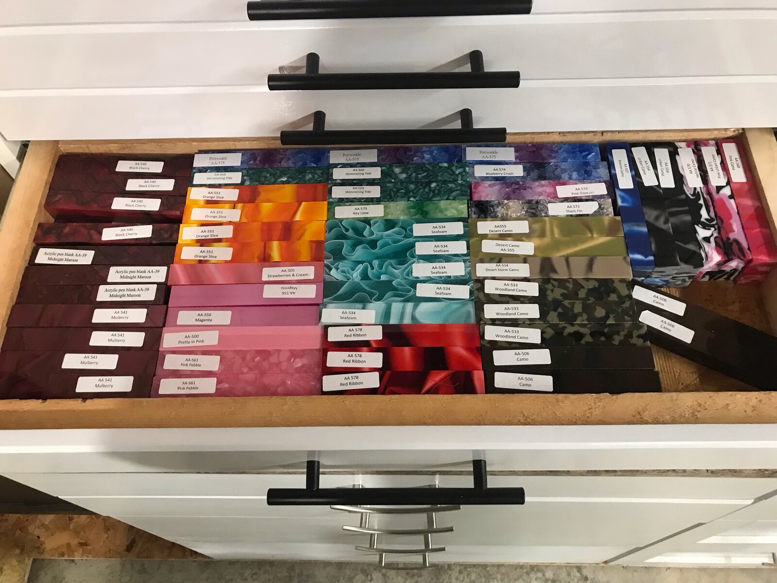

That is basically what I use. I bought a bunch of those rolling carts from Harbor Freight when they were on sale. Have a few for blanks. One dedicated for segmenting stuff and one designated for casting supplies and other odd ball things such as bottlestoppers and key rings and other things. They work well. Easy to move around if need be and they are out of the way. I do have too many blanks though. I could live 100 lifetimes and still not use them all up. Same with pen kits.😃
I also store my wood blanks in a drawer with no wrap. I only keep my ebonite blanks in their original plastic wrap.
