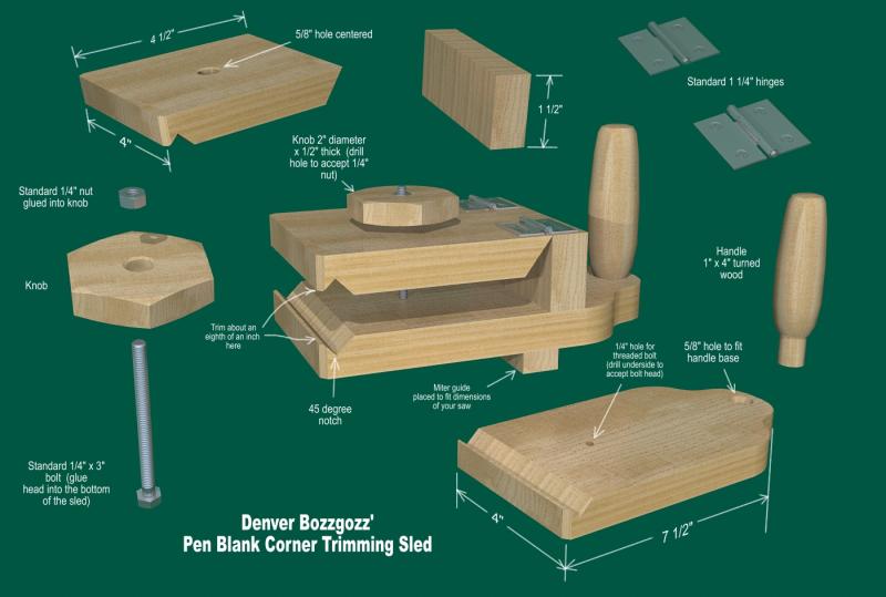

I recently found a jig for cutting off the corners of a blank, but I can't find it anymore. I looked through the library, and I didn't see it. I also looked through the last few threads and didn't see it... I probably looked right at it and missed it, but I wanted to build one so I had hopes someone else knew what I am talking about and could point me to it. Sorry to ask if it is right in front of me and I am being daft....

(The jig I am speaking of had dimensions, parts list and detailed pictures to build it. I think it was designed for a band saw, but could be adapted for any saw.)

When I started turning there was a jig pictured that you could clamp on your bandsaw to cut off the corners. It didn't make it round, but helped. Where it worked the best for me was on some softer pieces of wood that (with limited turning skills) I would get a catch and sometimes ruin a pretty decent piece of wood. Are you thinking of a jig along that line or something else?

That is exactly what I am speaking of. It was a nice little design to knock the corners off a blank to make it octagon shaped.

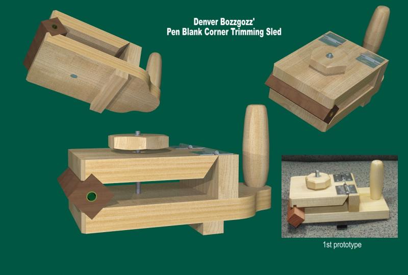

I think this is the one you are looking for. I downloaded them a while back. It's not mine and I haven't tried it yet. I haven't found a blank I wasn't willing to round on the lathe.

Here are a couple of pictures of the one that I made. It is nothing fancy, but gets the job done when needed. I made it from a 14 inch piece of aluminum angle (because it would be the easiest to open the slot I needed) attached to a piece of scrap wood that I had cut at a 45 degree angle and attach it with a C clamped to the saw when I need it. It is pretty easy to move and make any adjustments for larger or smaller blanks. I have used it on some pen blanks but mainly 1 3/4 blanks.
It is pretty straight forward, but if you have any questions let me know.
