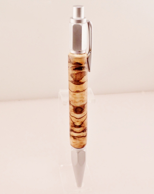

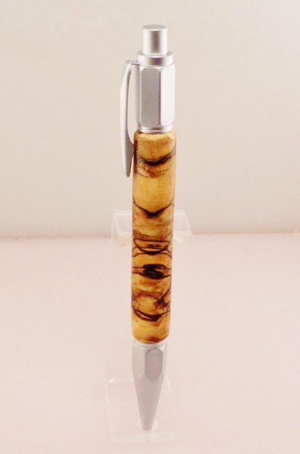

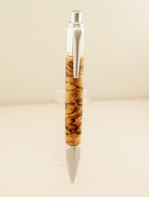

Rob; Normaly when turning any object you are turning both endgrain and straight grain anyway. The difference is that we try to keep the straight grain running the length of our turnings for the added strength. When you crosscut a piece of wood, the strength is only the distance between grouth rings and the board can easly be broken by hand. The beauty in crosscut pen blanks is the unusual grain patterns that will appear when turned and finished. End grain blanks will warp if not treated or weighted and stickered. You sould stabilize crosscut blanks or soak with thin CA every couple of passes to hold them together and add strength. Cutting or disk anding the corners will make turning a lot smoother and reduce catches. Sharp tools are a must, they need not be carbide, but they must be kept sharp. Here is a pen blank that was crosscut and turned. Jim S
