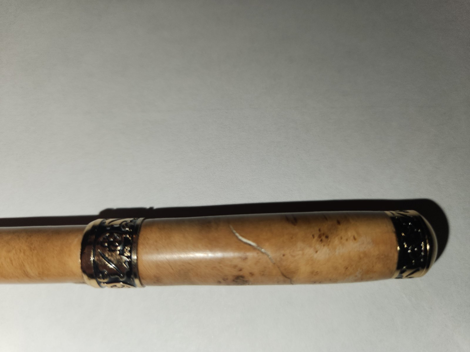

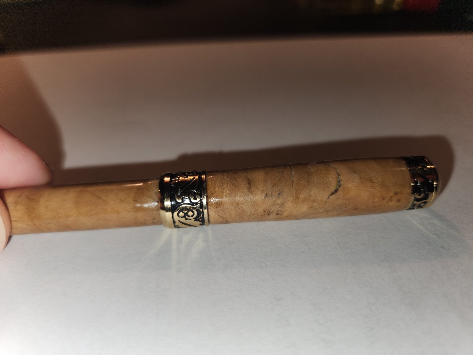

Ok, sort of embarrassed on this one. I turned this pen using olive wood I sourced from Trader Joe's (originally a cutting board). I turned the pen and damaged the coupler during assembly so the pen didn't get delivered and PSI sent me a replacement (the instructions shipped were outdated and missed a key step). So, the pen has been sitting for the past several months and as I returned to the task of fixing it, I noticed that the upper barrel developed swelling and cracks. So, I'm not sure if the wood movement is due to how I finished the blank or it's my source :(. After applying a few layers of CA, I used micromesh pads, then buffed using Beall 3-wheel setup. What did I do wrong???
I have done a few pens from the same type of trader Joe board. I've wonder if it swelled a little along a burl line
All the pens I've made from olivewood cutting boards have cracked. They come off the lathe fine, then you look at it two months later and they're cracked, just like you said.
I gave up on these as a source for pens. But every Christmas people are posting about them. So maybe someone else is having better success. 🤷‍♂️
