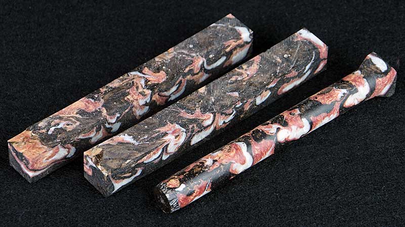

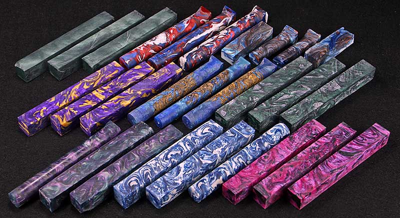

Some months ago, Jonathon (Brooks803) drove several hours to the Raleigh, NC IAP chapter meeting and gave a demonstration of colored blank pouring using PR and Alumilite. Later, I caught the Coastal Scents Black Friday sale and bought a bunch of mica powder. Then, in February, Jonathon headed up the Birthday Bash Casting Contest, which prompted me to do my first PR color-pour. That was interesting enough that I ordered some Alumilite - and now I just can't stop.
I've been compelled to try out all the different colors, and each time I hear or see someone ask "can I get a blank in x and y color", I feel challenged to make it.
Here are some examples:
attachment.php
So thanks Jonathon - I credit (blame) you for this new hobby (obsession). I couldn't (wouldn't) have done it without you. :biggrin:

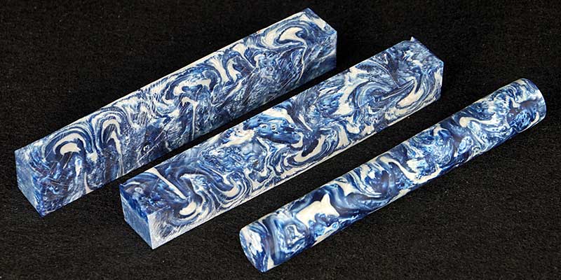

The next cast, however, I mixed two blues and a white (with the same swirl technique) to produce these:
attachment.php
I was trying to make a blank that looked like a blue sky with some puffy white clouds, but got a hurricane instead (reminds me of the sorcerer's apprentice). Not what I had envisioned, but pretty nonetheless - at least I think so. Sometimes unintended results actually look better.

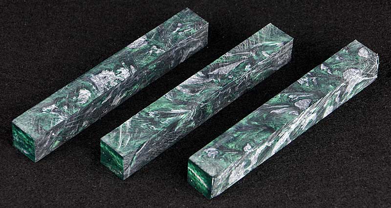

Later, I wanted to mix a light brown color so I combined red and green dyes. For some reason, the result was light gray. I added "crystal ice" mica powder and got silver. At that point I decided to pour "Slytherin House" colors. I mixed Emerald Isle mica powder, Black mica powder, green dye, and (because I thought the Emerald mica powder was a tad on the yellow side) a couple drops of blue die for the green. This was the result:
attachment.php
I think I'll have to order some Alumilite White to try making flat (not mica colored) colors. Likewise, I may stop at Illstreet composites the next time I'm in Charleston unless I can convince my fiberglass friends to get me some Silmar 41 cheap.

It looks like you might be joining the "Alumilite 55 gallon Club!" Nice blanks!!
Even with the not so great trials the whole bunch beats the most big name suppliers like Woodcraft and you have just started. Thanks especially for sharing the detail info on what you were trying to accomplish and listing the negative results. Usually all we see are the sucesses.
I made the blue and white "hurricane" blanks with Alumilite clear and mica powder from Coastal Scents. I poured equal parts of resin mixed with Pearl White, Blue Silver Star, and Colorona Light Blue mica powders. No dyes were used. At the rate I'm using it, I'll be out of Pearl White soon.
I picked up 4 Castin' Craft plastic molds cheap several years ago when a local craft store went out of business. So far, I've only been able to find 2 of them (but I'm still looking!). I've also tried using a sports-bottle-ice-cube-tray that I picked up at Wal-Mart. I havent' gotten good mixes in the vertical molds though. Single-color PR pours work ok, but that's it.
That also brings me to another "lesson learned": Don't use "baby soda bottles" for Alumilite. The cured blank simply won't come out. I've tried compressed air, PVA mold release, and lanolin. The only way I could get the blanks out was to turn the plastic tube off on the lathe. I'll try them again with PR sometime.
I hope that helps,
Eric

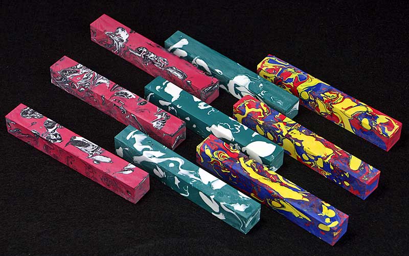

Alumilite White

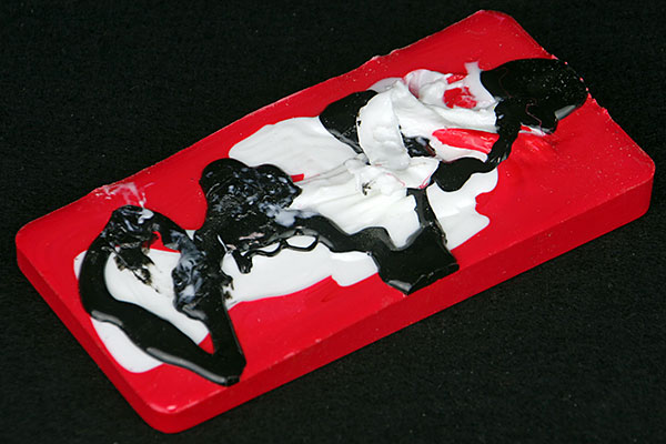

I ordered some Alumilite White to try making blanks with solid colors. I was a little slow on the first pour. I put down layers of red, white, and black, but before I could add more red and stir, it set up in the cup. Oops. This stuff kicks off fast!
attachment.php
On the second try, I didn't add enough red dye and it came out too pink. Also, the white isn't prominent enough. It got drowned out by the black. So, I tried again, but with green and white this time. It came out better. Next, I went for primary colors. I mixed mica powder in with the dyed resin to add some sparkle, but I can't tell that it made any difference.
attachment.php
It's an interesting material, though - quite different than Alumilite Clear.
