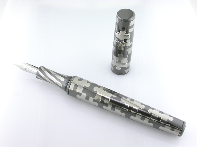

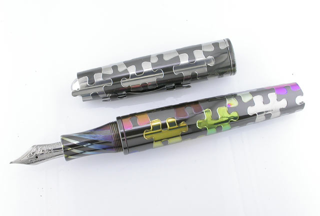

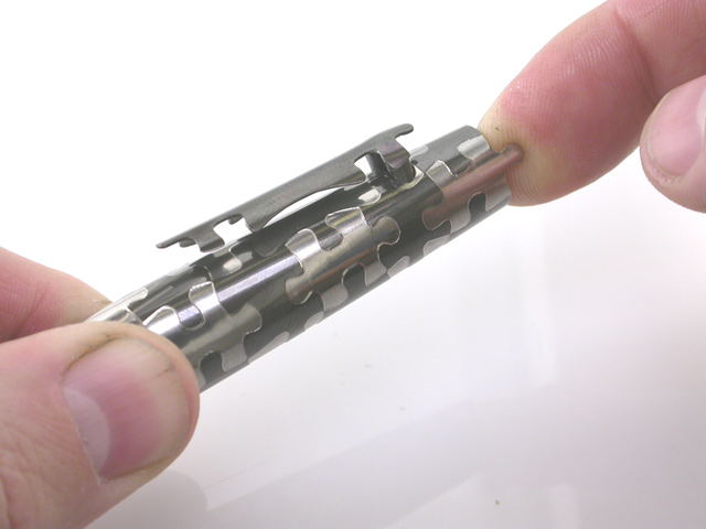

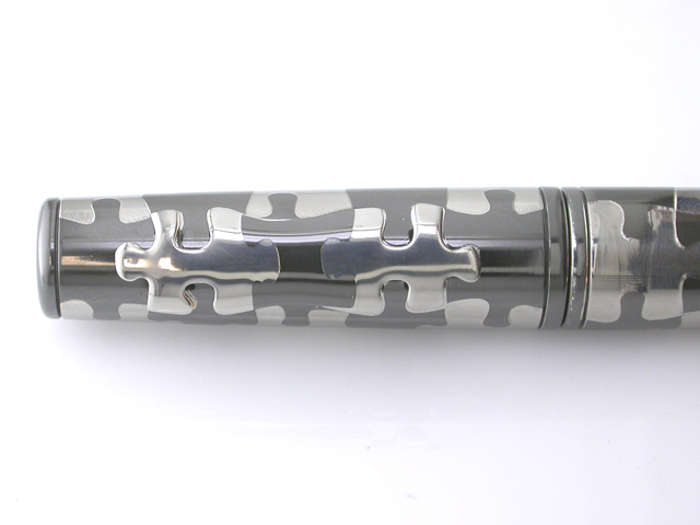

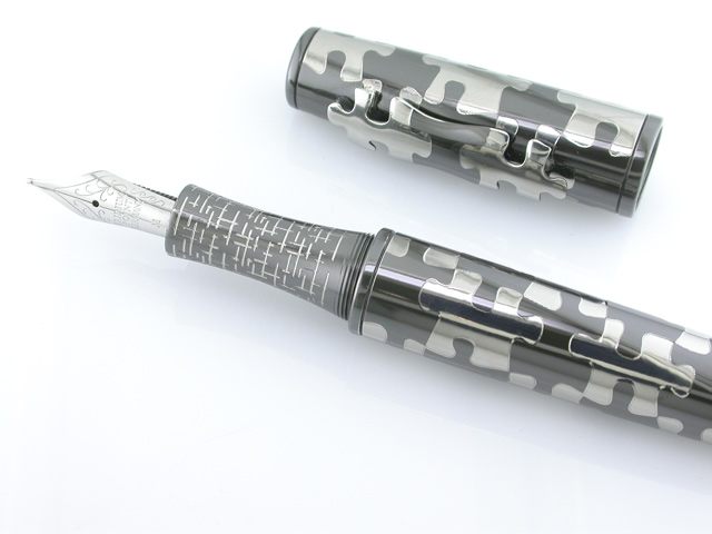

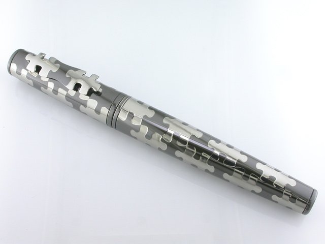

Here's a pen I've been working on for a while. The pen is made from zirconium metal and gets a dual black and mirror finish in a process that I had to figure out. The black is a ceramic and is very inert. The cap threads are dual lead so that the pattern lines up with alternating pieces no matter how it's put on. The clip is the same material, and looks to line up with the pen as seen from the front. It is laser welded to the body. The section was originally done with a spiral, but could have a hatch pattern if the customer prefers a more subtle look. I had originally designed the pen to have vibrant anodized colors, but the majority of people seeing it prefer the simple and classy black and mirror look. It will have an 18K nib, and accepts cartridges or a converter.
