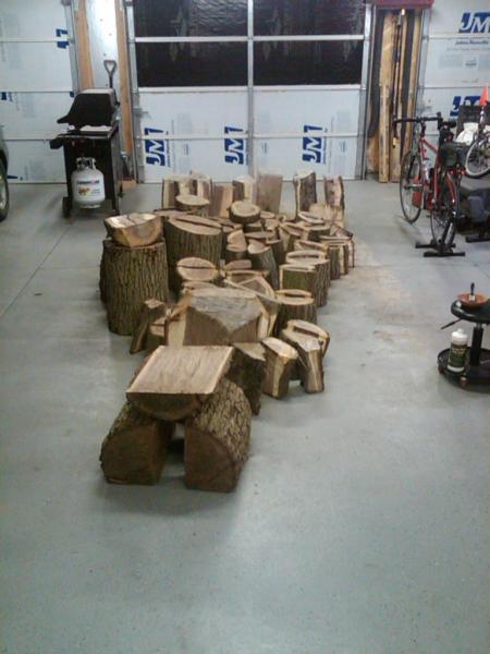

I have similarly sized walnut logs that I cut up a couple years ago. Most of it got halved and quartered, depending on the size, then I got a gallon of wood end sealer from Rocker and double-coated the ends to prevent checking. It's all in the upstairs storage area of the garage until its got a 4-5 years air drying before I do anything else with it. So far, everything looks good so the plan is working.
There's a few really big chunks that I might not touch for a decade! I don't even have a big enough lathe or bandsaw to handle those fellas yet...
Attached are what I got to give you size comparison. Obviously, if you cut into smaller slabs because you want to do segmenting work, your drying time will be reduced considerably as well.
