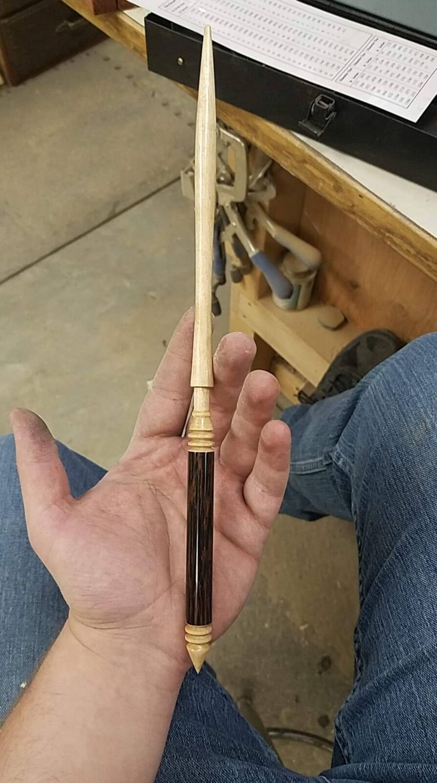

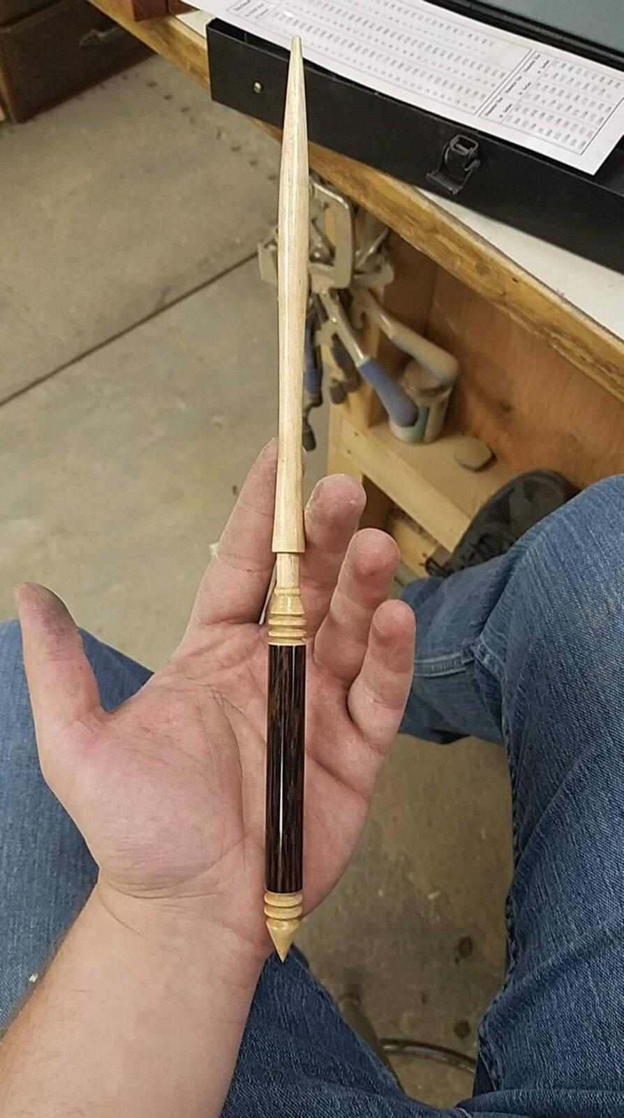

This magic wand is probably my favorite item I've made with black palm so far.

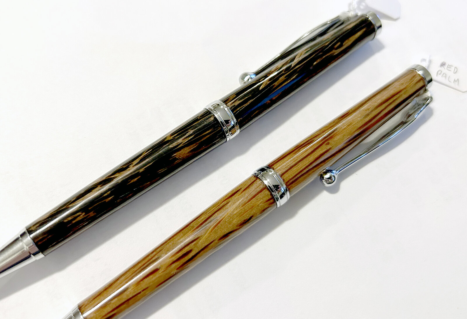

I'm so glad you asked. This was one of my first pens when I didn't know any better. You know, when all your cuts are finishing cuts? The top is end grain too! It took me Forever but I did it. I've since turned red palm for a gavel handle and that was much less fun as I assumed myself skilled enough to get it done quicker - splinters galore!
I didn't have much trouble with the red or black palm. I used sharp tools and tried to be patient. I also use the band saw to take the corners off before going to the lathe so the blanks start round, not sure if that helps.
