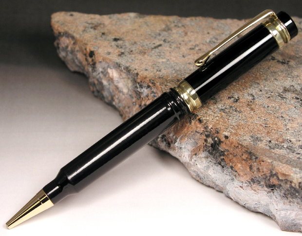

Just a thought I played around with. Black powdercoated 300 win mag with black acrylic top. Brass bands are clear powdercoated too. I will likely replace the acrylic on this one with some ebony or blackwood. As always say what you like.

I am not generally enamoured by shell pens,,,, BUT this one is really cool... fantastic effect... definately different... a stealth shell pen... too cool

That did turn out nice. I too am not a big fan of shell pens but have not seen one that nice before. Great job, nicely done.
