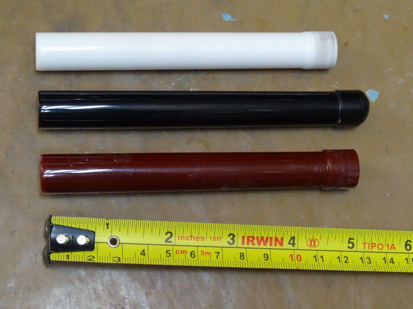

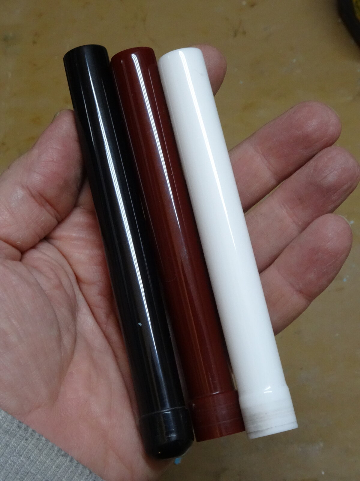

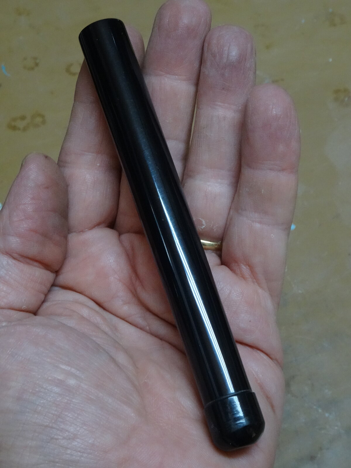

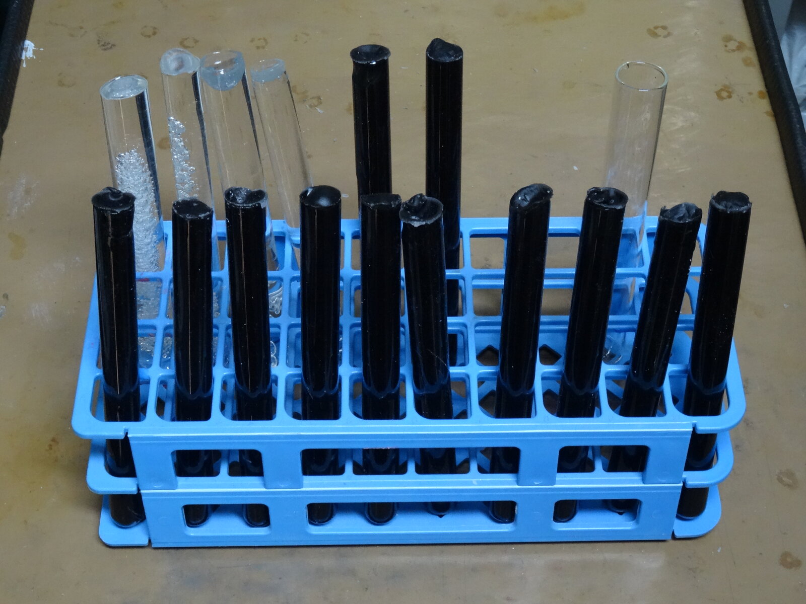

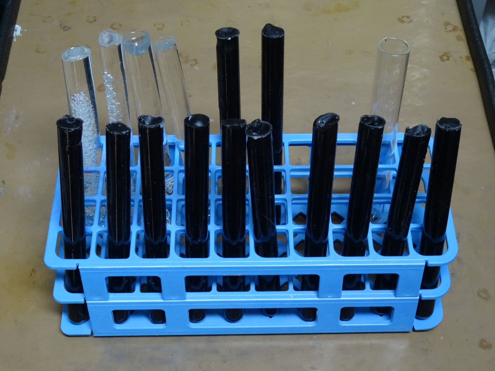

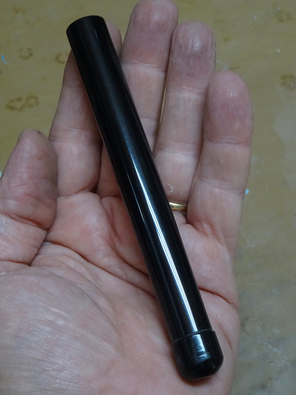

Maybe I can help. I produce PMMA acrylic rods for my own use by casting method. I didn't find it on the market in the specifications I was looking for, so I decided to produce it myself. Acrylic casting is harder than extruded, resistant, easy to machine with carbide tools. Sanding and polishing is also simple and produces parts with high gloss and scratch resistance. However, I warn that due to the hardness, if it is not worked correctly, it can chip, crack. Anyone who is used to softer materials such as wood and plastics may be surprised. I don't make square pieces, the material is polymerized inside glass tubes, so the rods are cylindrical, usually 15 or 16 mm in diameter, length +/- 130 mm. Is this the material you are looking for?
