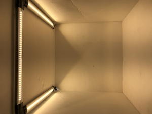

I am trying to use my Iphone 7 for taking my pictures, but have run into a problem.
I built a box out of white foam-core. I had 3 LED strips from an undercabinet light kit available, so I mounted them to the top.
The first two images show the lightbox I built and the LED set up. You can see, that there are no black lines in these pictures.
View in Gallery
View in Gallery
The last two images show the black lines that appear when I try to photograph in the box. One was taken with the camera horizontal, while the other with it vertical. The lines seem to follow the orientation of the camera. This would appear to indicate that it is a camera problem, not a light problem.
This image is the right way up, the bottom of the photo is the bottom of the lightbox.
View in Gallery
This image is sideways, the bottom of the lightbox is to the right of the photo.
View in Gallery
If anyone can shed some light "pun intended", I would be very grateful.

The cause is interference between the light "frequency" and the speed of the shutter in the camera or phone in that case. This is for both LED and incandescent light bulbs, using sunlight as the source of light fixes that :) Or use a longer shutter speed but I don't believe you can control that with a phone camera.

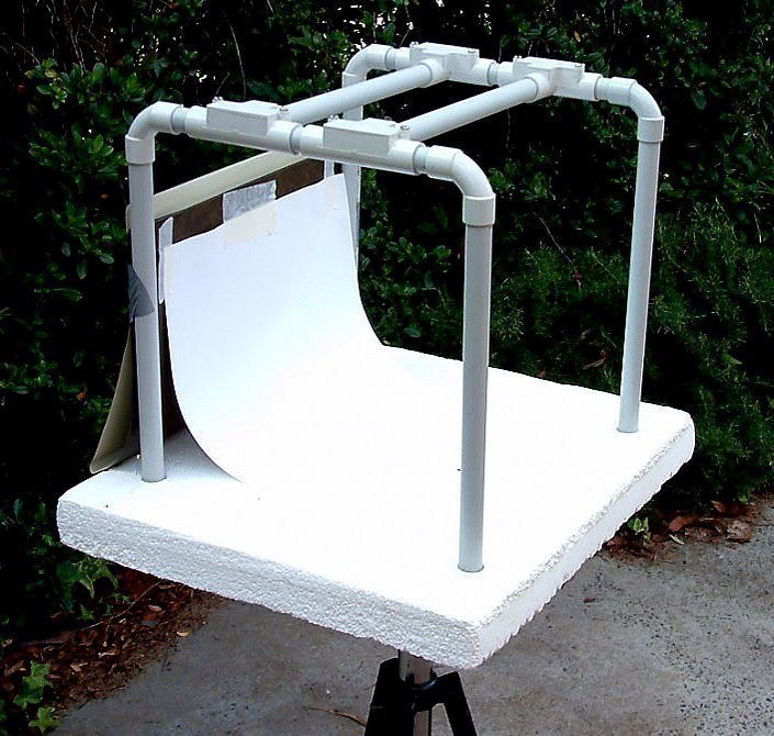

My open conduit box,one light shaded LHS and one RHS and 8 watt fluro on top.
Side lights from hardware store LEDs
Peter.
