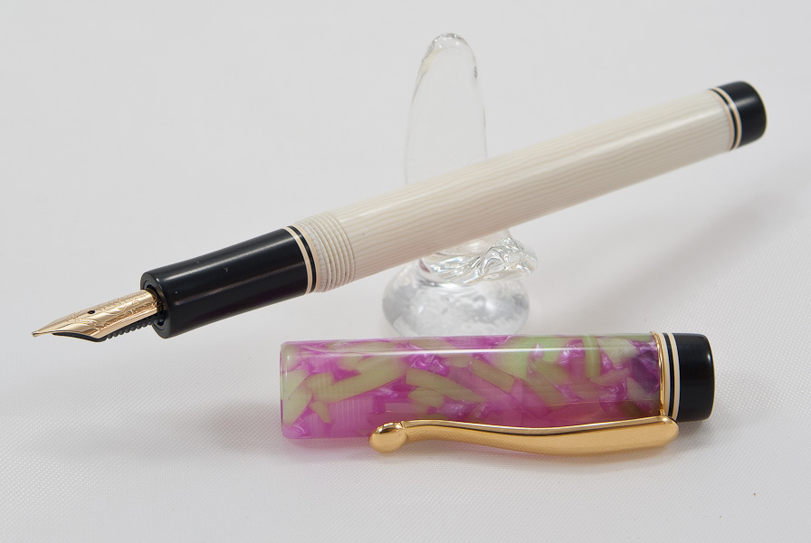

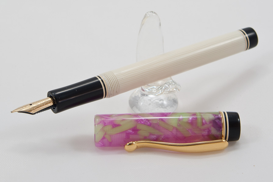

I've used pickguard for accent rings. The triple-layer black/white/black or cream/black/cream were my favourites as in the pic). The layers are solid colour (some are sparkly). I don't remember where I got a "sample pack" - 4 or 5 two inch squares - for not much more than the cost of postage. Definitely easier than building up the layers from individual sheets ;)
That is a beautiful pen!!
