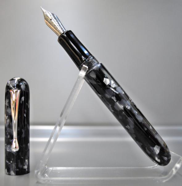

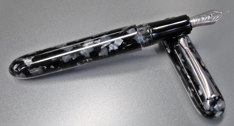

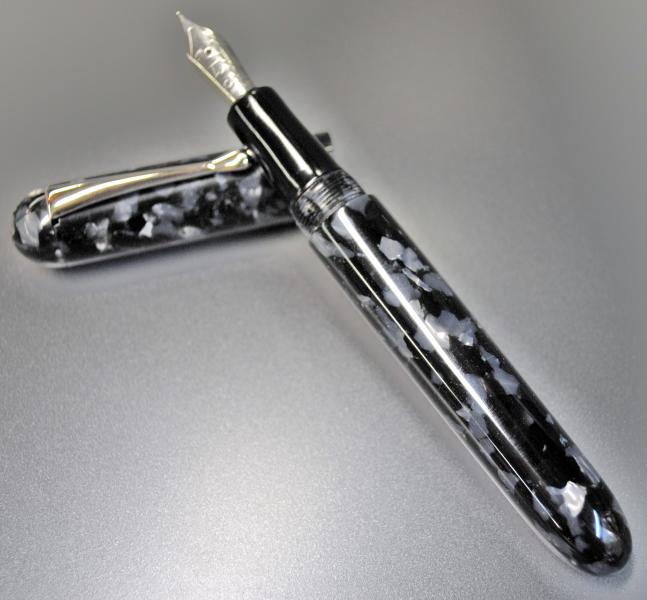

Details:
Black ebonite grip section
Cap-body join--14 X .8 triple start threads
Section barrel join--10 X 1
Finial-cap join 12 X 1.5
Bock #6 medium polished steel nib w/feed
27 grams
5 5/8" long with cap screwed on
11/16" cap diameter
5/8" barrel diameter
Questions, comments, suggestions welcome and appreciated.

Looks very nice. I like the way you kept the cap diameter close to the barrel diameter. At least to me, that keeps it from looking too heavy. Is there something, colorwise, going on in the clip, or is that just a reflection?

I think it is a reflection. In the last picture the nib is also reflecting the gold.
Robert. A gorgeous pen to say the least.
Are you using a buffer to bring out the shine in the Cebloplast?

Think it must be a reflection. The clip is one of those rhodium jobs from IPD.

I don't use the buffer on my pens, just Hut plastic polish and Novus. I look at the finish through a 20X headset. The Hut stuff takes out the small scratches but I throw on the Novus because I have it.
