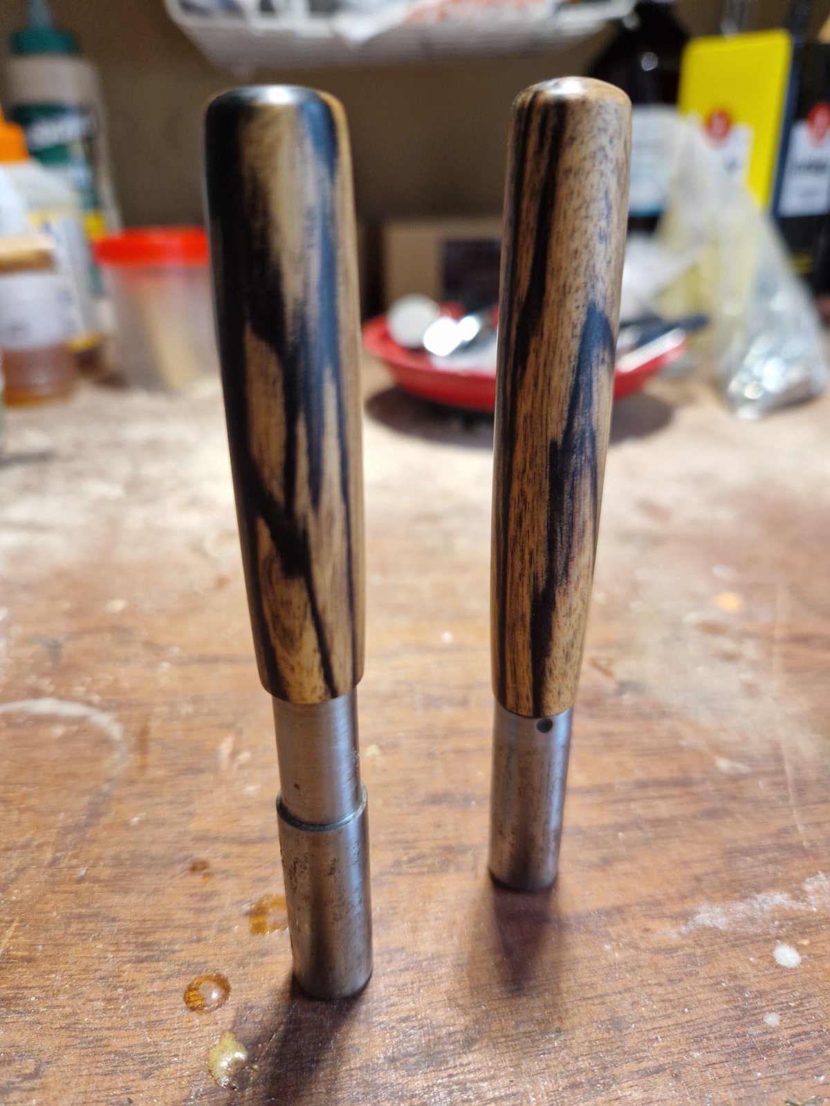

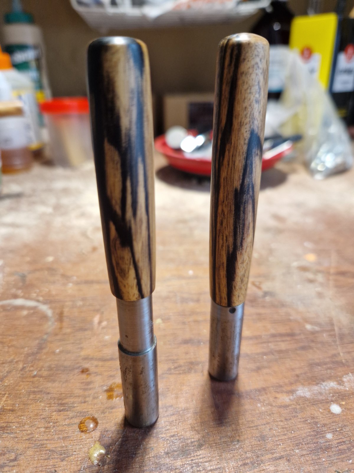

I decided to use a diy paste wax ( 1 part walnut oil, 1 part carnauba wax and 1 part turpentine). The thinking behind this is that the wax will heat when buffed and fill the wood pores, the oil will also form a surface and the turpentine will act as a solvent and speed up drying a bit. The paste is somehow hard (carnauba is a very hard wax) but soft enough to be usesd with a piece of paper/cloth or dremel buffing wheel. Will it work on the long run? I have no idea. Will the oil of the ebony eventually come out of the wood and mix with the paste? Maybe. I ll keep you guys posted. Here is a picture of the blanks so far. Cheers

Love that look!
