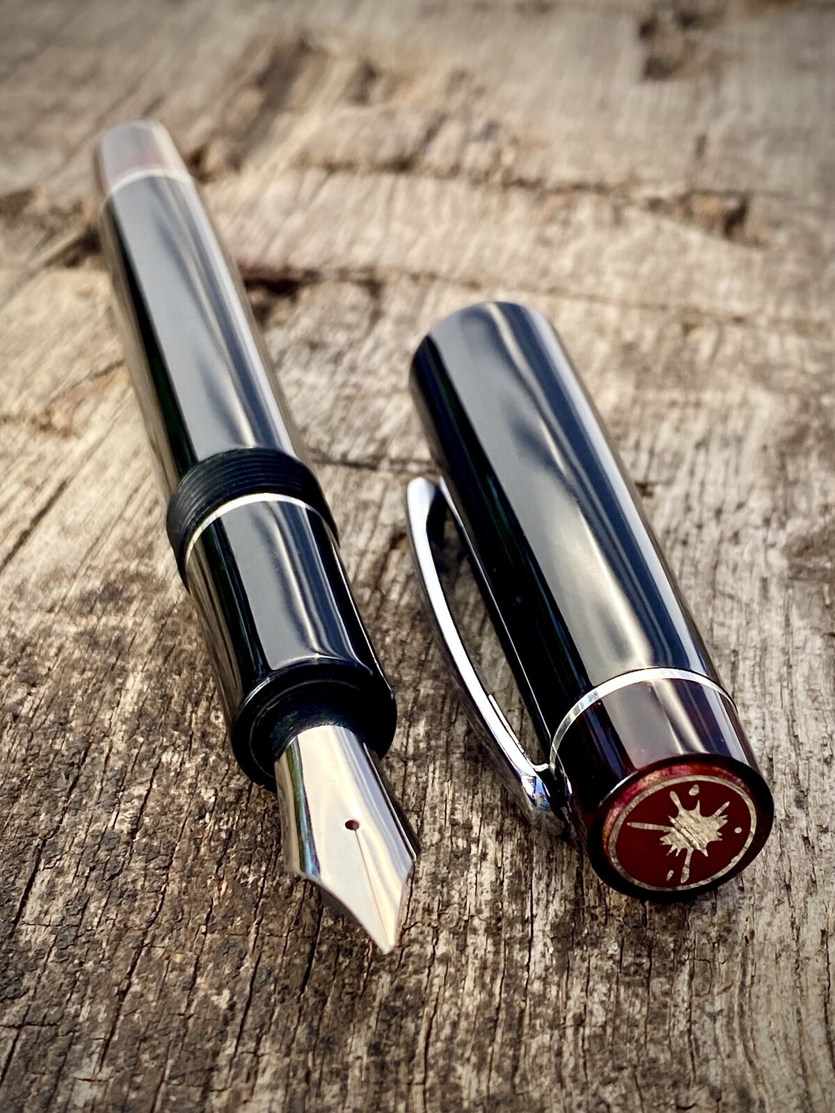

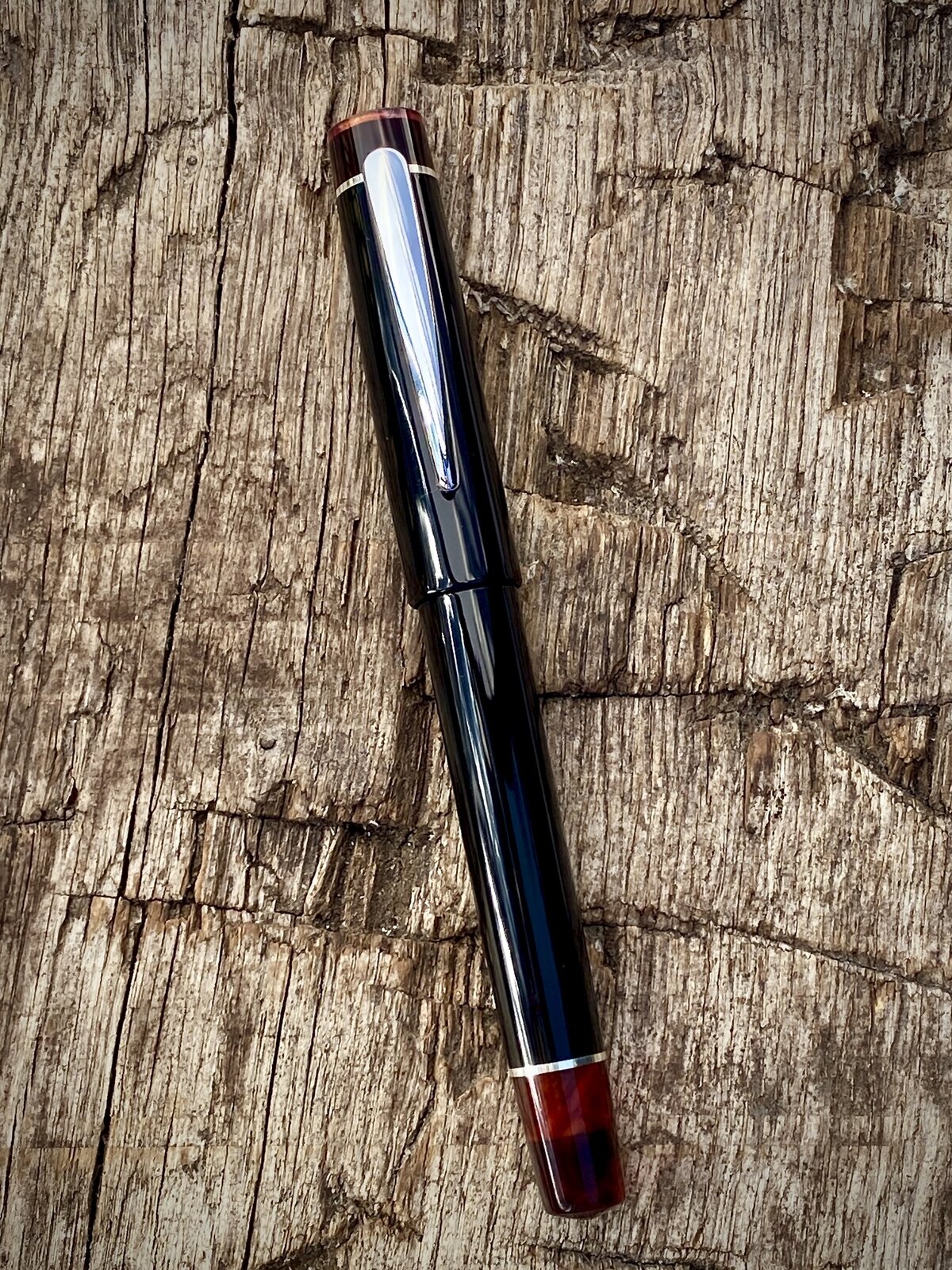

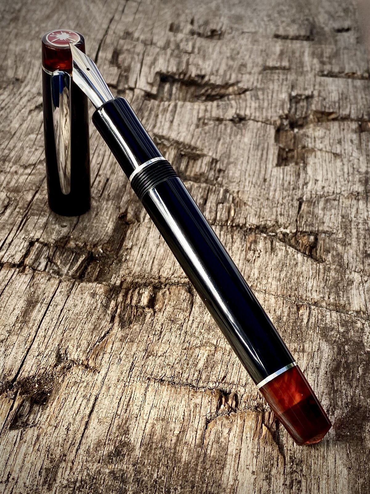

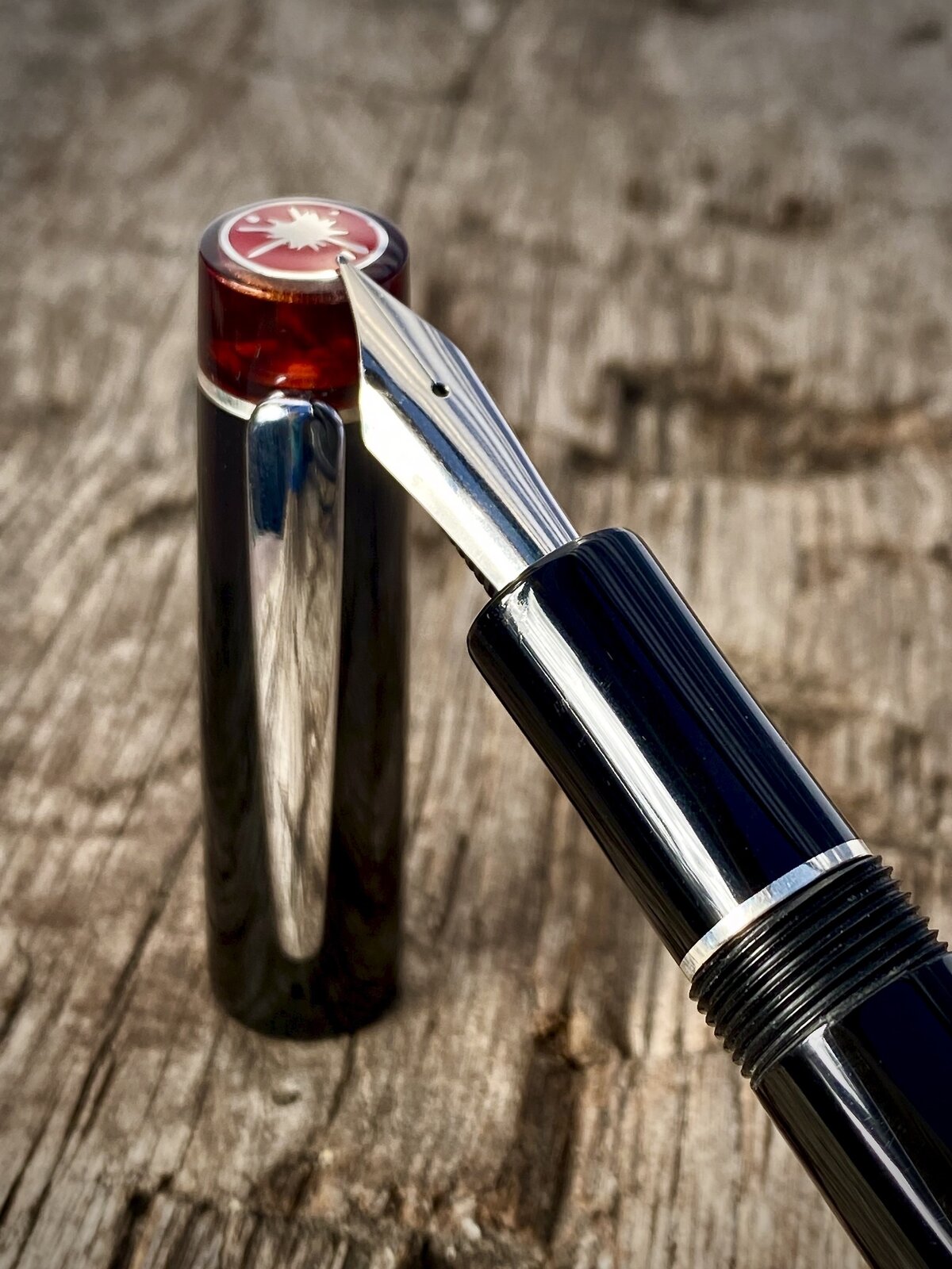

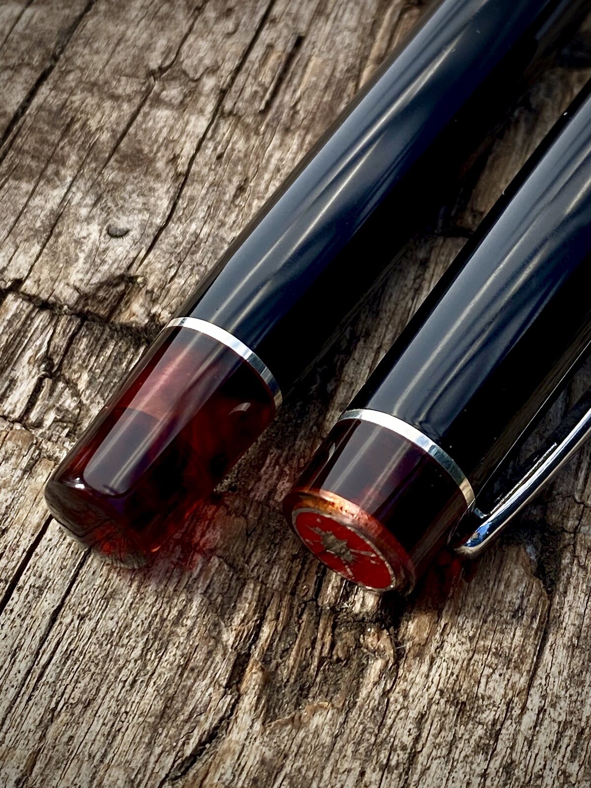

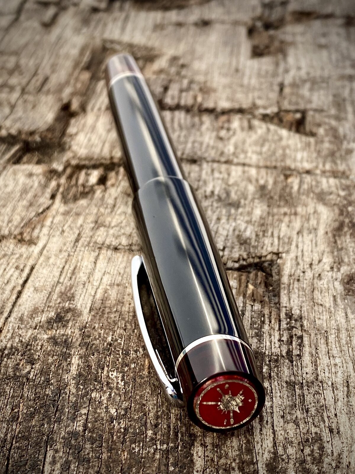

Made this one for myself. I'd previously made one for my own use but forgot to add the clip when I was making it and glued the finial into the cap. That was wood and cellulose.
This is made from vintage black cellulose with a modern deep red cellulose for the accents. The clip is chrome plated and the rings are sterling silver.
The nib is the same dimensions as a Bock no6 but it isn't made by Bock. It's a fine flex steel nib with an ebonite feed.
It has 13mm threads and no step on the barrel. Overall length closed is around 140mm.
Cheers, Ash

Simply stunning. Can you tell me where you got the nib? I would be interested in trying a flex nib.
Thank you. The nib is from the turners workshop here in GB. I don't think the flex nibs are available quite yet as I last heard that they're being tested, but you can buy the ebonite feeds and housings.

That's a beauty! I love your finial. How did you do that?
Thank you. I have the coins cast in sterling silver and I designed them so that I can either clean them up and leave them plain or, as in this case, fill the negative space with coloured resin.
