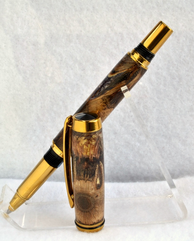

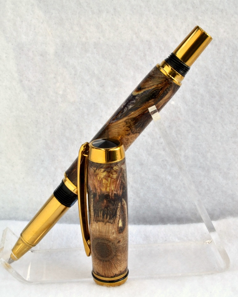

..from down under. Thanks George, nice blanks! I received the blanks ( 7)
about a week or so ago and have been taking my time as they seem to be, and they are somewhat fragile. I did tape the blanks after cutting to length with a bit extra. I also glued a small section of acrylic to the ends to stop any drilling blowouts! Before glueing in the tubes I used thin CA and sloshed the blank's interior, let that sit overnight and then glued the tubes into the blanks. Turning was a bit tedious. Even with very light cuts I could only make 3 passes before resealing the outer surface w/thin CA to help keep it together. The hairy fibers had been exposed! I used this process 5 times to get the blanks to size. I still dealt with 2 blowouts. One was a 1 piece section and the other was a 4 or 5 piece explosion. I found and replaced the parts and also mixed a slurry to fill a few small voids. All in all I like the Banksia blanks, just not the stress of turning them. Think "Scary Sharp Tooling!" Hope you like the results on this Gent Junior. Be well .......Jan

I never said the prosess was going to be easy Jan !! But the results are fantastic and worth the pain of turning. Wish you had a few more photos of the lower barrel and the pen in the closed position. George always comes through with great blanks !! Jim S

OH beautiful pen and the process description is very helpful! Thanks!

Great Work, Jan.
Congratulations on Facing and Defeating your Trepidation.
As well as the Feeling of Accomplishment,
You have left as a Trophy, "A Fantastic Pen, with a Magnificent Blank".
Exhibiting your Excellent Fit and Finish.
True Craftsmanship.
