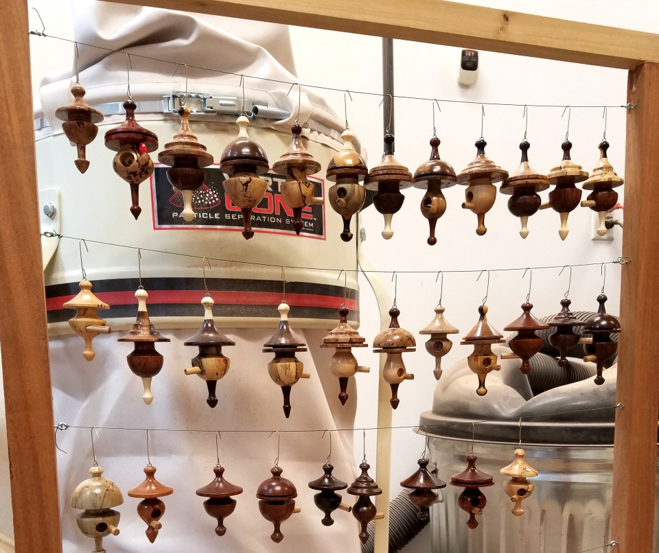

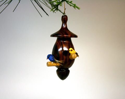

Sold a lot of these this season. Pic taken before birds were on them.

Rodger they came out very well. They are good sellers. I too make them and they have been good to me as well. There are so many ideas you can do with them also.

Really nice ornaments, wonderful assortment. Looks like somebody has been very busy. Question: How is the wire hanger installed into the top of the ornament?

A very good question. I use this from Hobby Lobby:
2mm Nickel End Springs | Hobby Lobby | 477943
I drill the appropriate sized hole (9/16? Can't recall) in the top finial and then glue the spring in below the level of the top coil.
