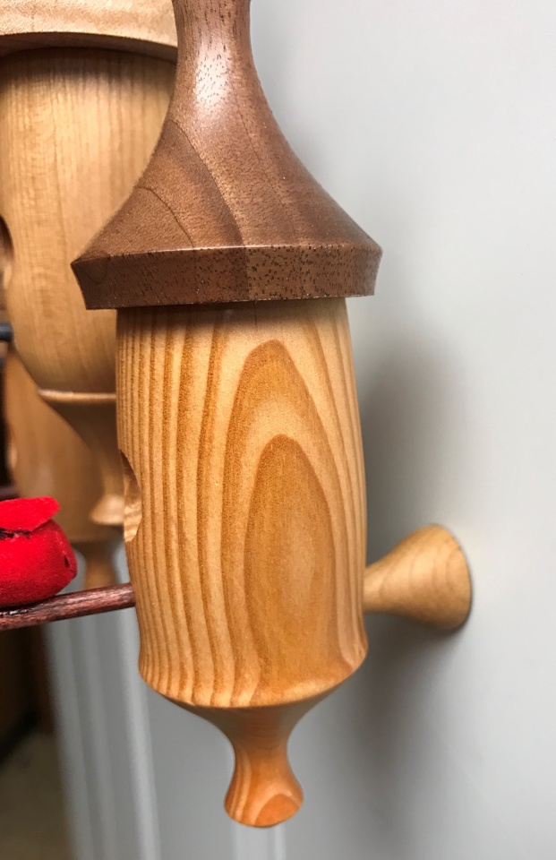

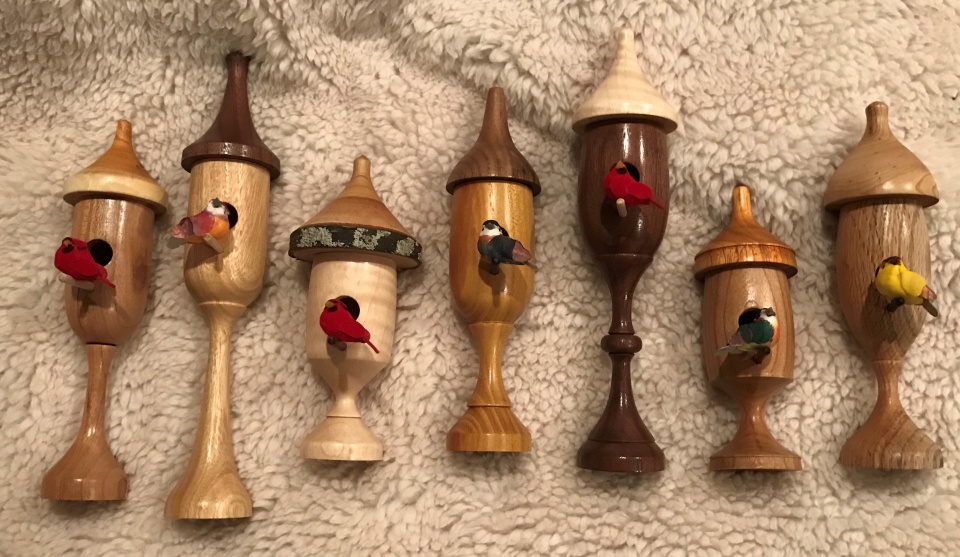

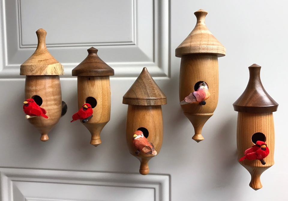

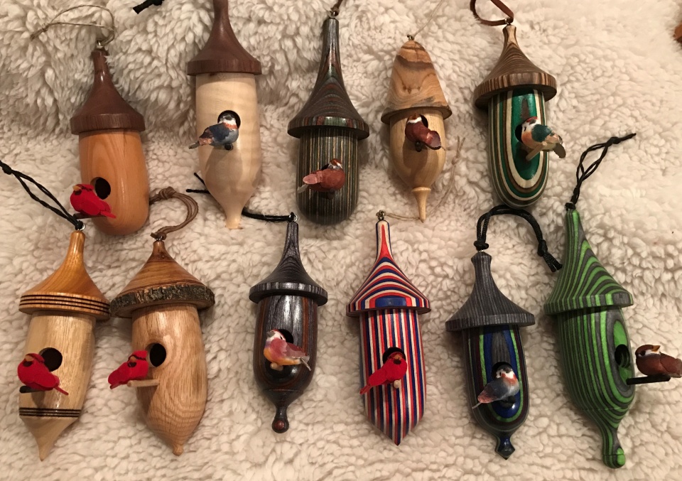

Hey all,
I had to make some birdhouse ornaments for an upcoming show so I decided to spice things up a little bit. I've got the usual hanging ornaments and stands but a little idea popped into my head with the magnetic ornaments. I made a little arm with a magnet and viola!

Those came out real well. The magnetic ones can wind up on the fridge too. Fun to make and they do sell well at shows. Thanks for showing.
That was my intent :). I just threw these on my shop door to take the photos...
That magnet idea is gold, pure gold!
