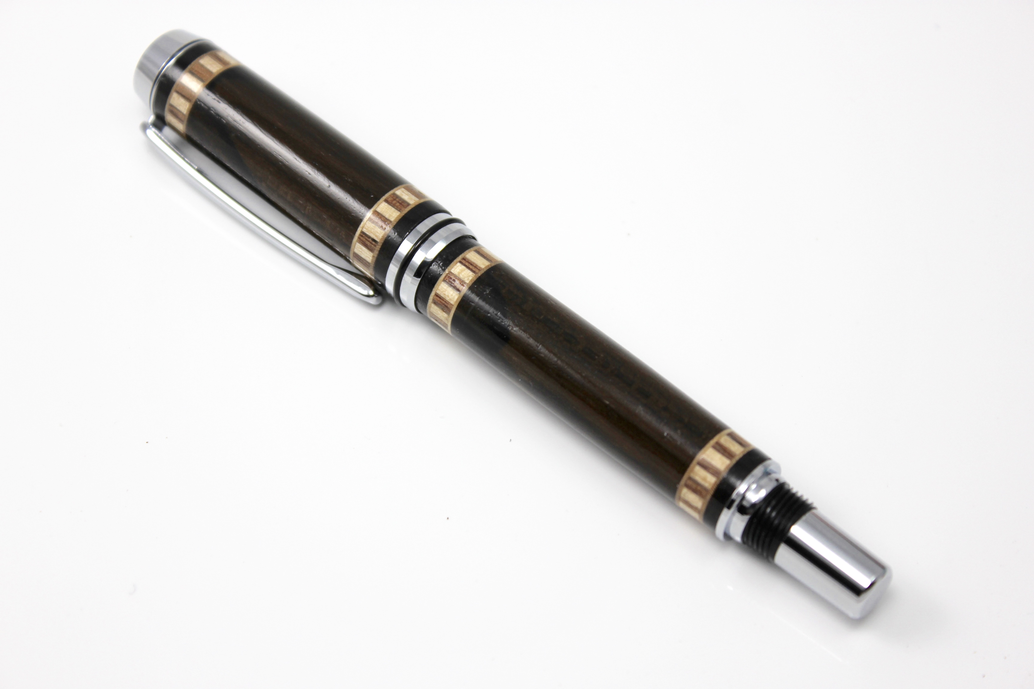

This was a "proof of skill" pen. The billet rings are fairly common, but whether I could make them was another issue.
A few quality issues need to be worked out, so I guess I'll have to keep this one.

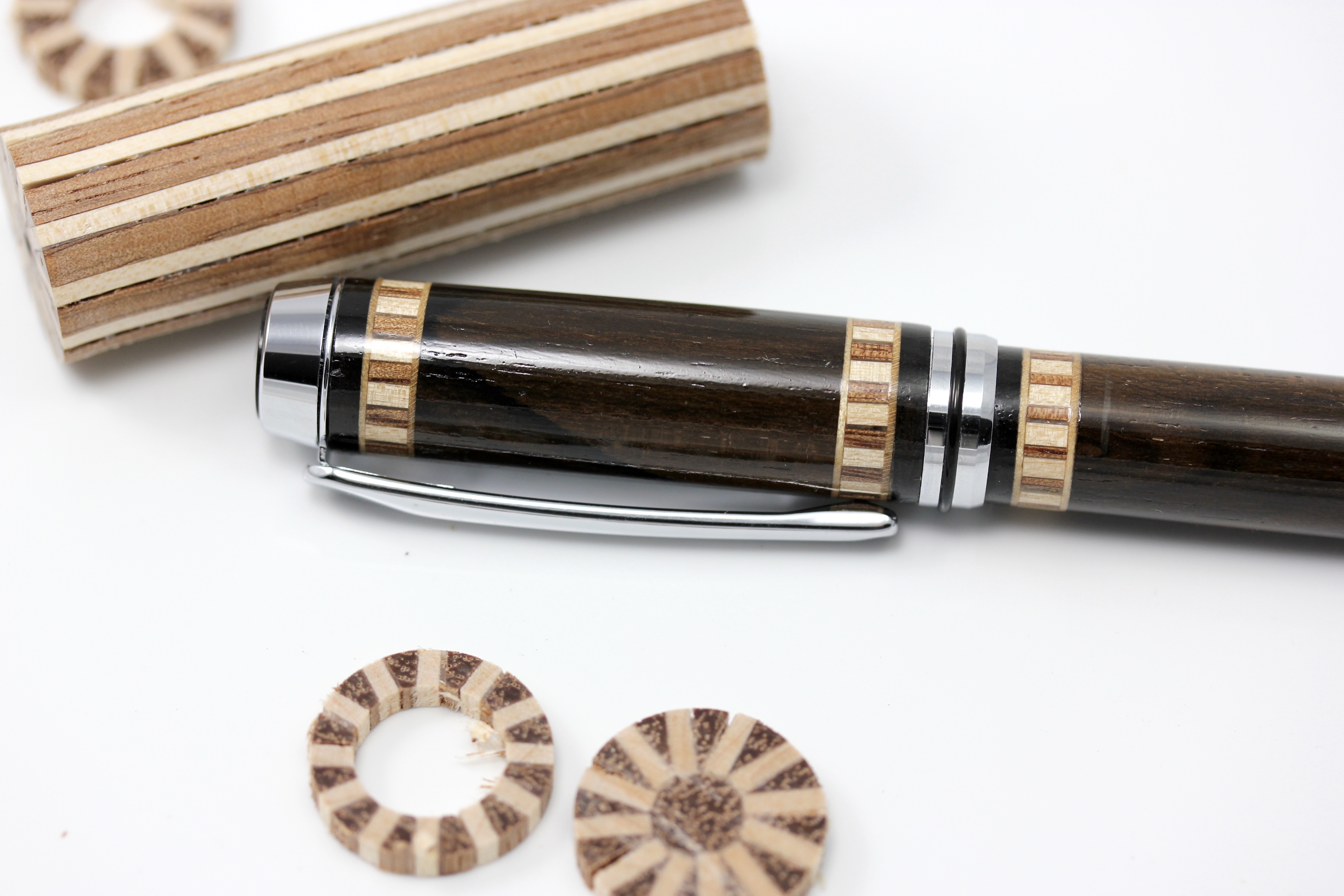

Back to "technique". Next I tried a square blank; made it into a hexigonal shape, and made slices in it on a precision table sled. Nailed it the second try! Added the stringers. That blank was beautiful. But not the third, fourth, fifth, six, seventh blank! Gave up! I just got LUCKY on the second try; Big blow to my ego, it wasn't skill at all! :rolleyes:
NOW, when you get this worked out, I am all ears and eyes.
Wow! Really have to do the math to get the angles and thickness correct. That would be fun to try!
For me little math involved. I cut the slots with a slitting blade, in this case I believe it was .060" (Wisconsin Knife Works, Slitting router blades).

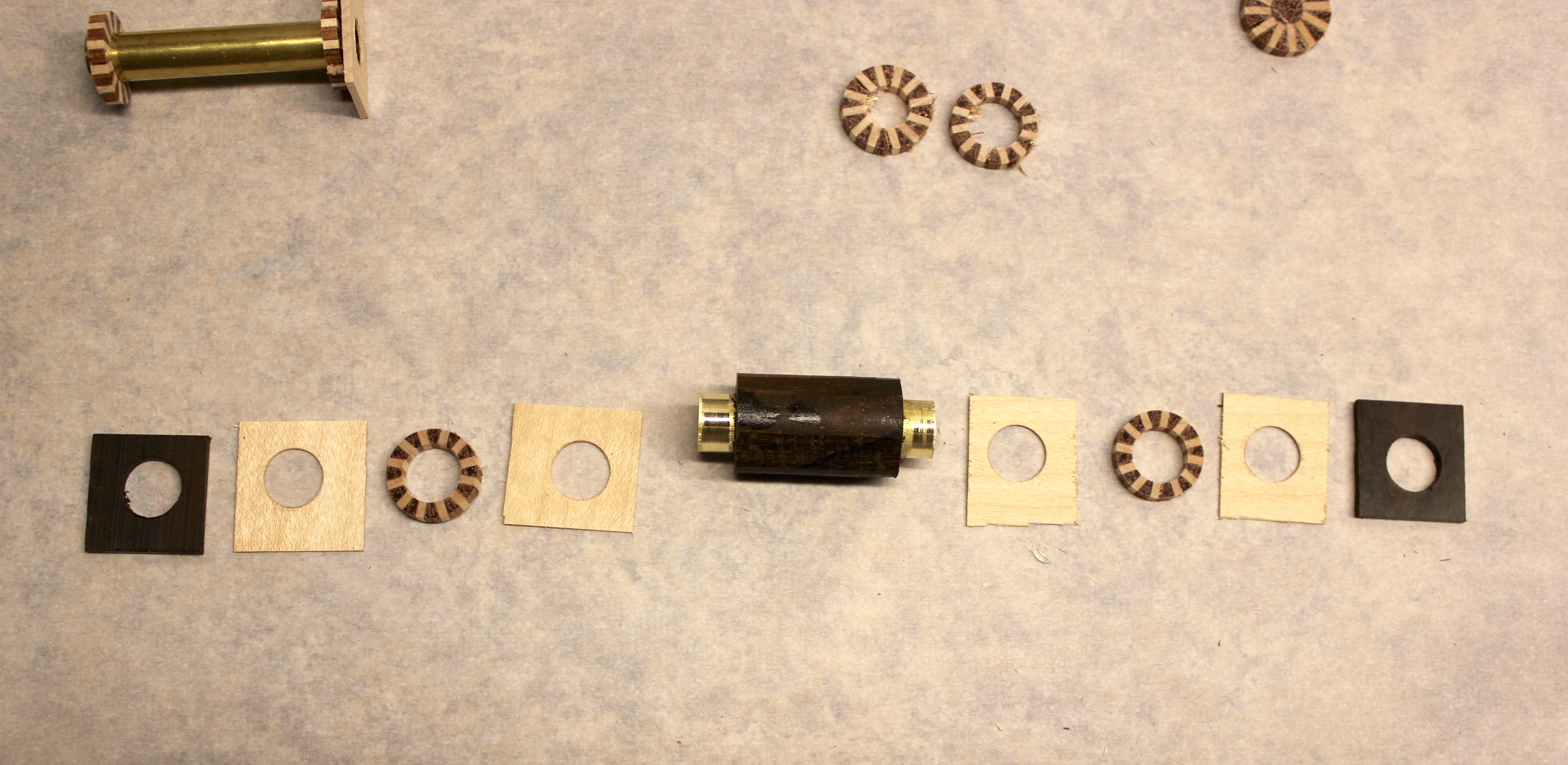

Then I had to make/sand the inlays for the slots (about .065" allowing space for glue). I have a Byrnes Thickness Sander, so I am able to take 1/16" stock and sand it down to size.
I do have a 6" blank drying where I have a Red/Black/Red inlay. The glue looks OK, so it may be a fun set of rings.

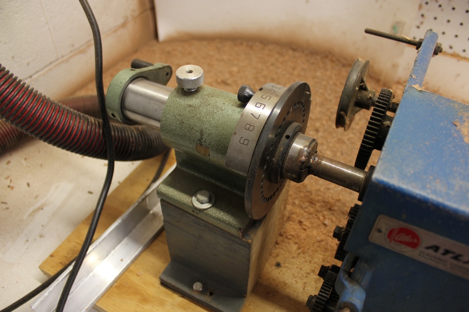

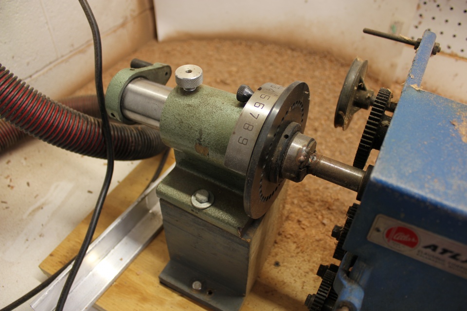

Well Hank the thing about cutting slots on a lathe is that you can index the spacing very easily without all the math. I have shown these pens countless of times here and have shared with all my method of doing slots. I use a router and a jig to support this. The only limit I have is the smallest bit I have for my router is a 1/16" bit which is as small as I would ever consider of using anyway for design purposes. I could reconfigure to use a dremel drill motor and go from there but I find no need for this. I do not know how Mark did these and if he is using a tablesaw then it is possible he is finding it somewhat hard to hold the accuracy, even with an accurate saw as he has. But that is the fun in things. Trying to work out those problems and developing your own methods. I did that with my method and it lends me to be able to do other designs which I will get into at a later date.

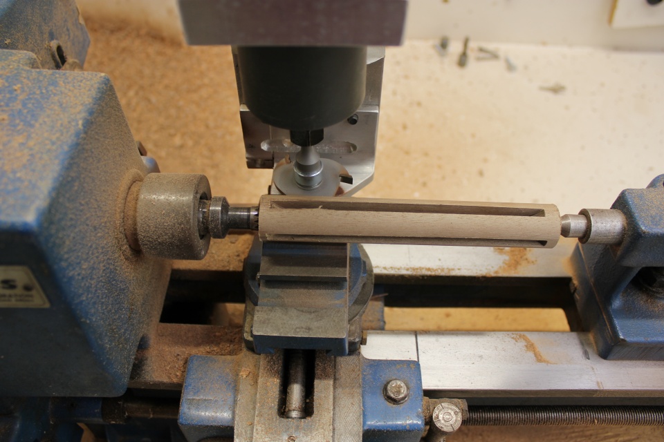

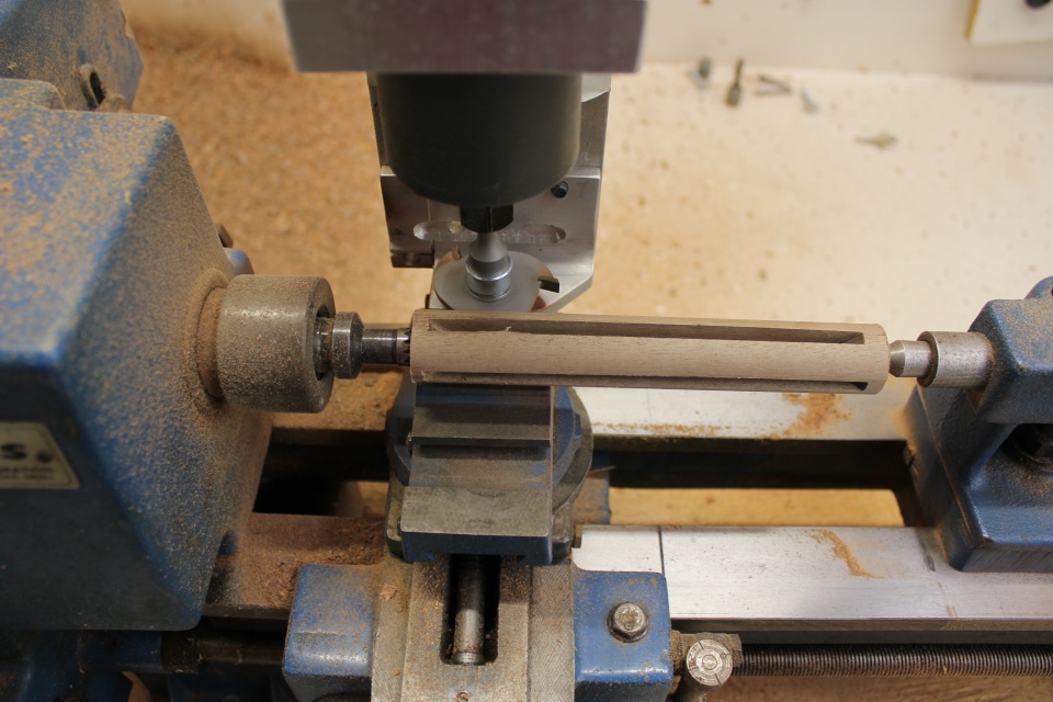

No, I did not use a table saw for these slots. For this pen, there are 12 slots, with a slitting blade of (.07"). I do have thinner blades, so it might be possible to get a 16 slot blank.
I feel the slots are very even and accurate as long as it is set up for the center of the blade to be in line to the points on my centers. After that I can cut the 12 slots in about 3-4 minutes. For this blank, I actually cut 4 blanks, and am working on some nicer inlays.

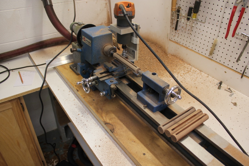

I thought I had previously described it.

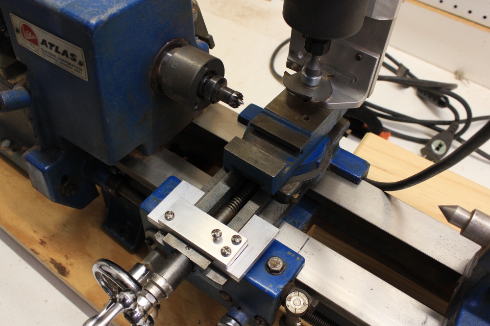

I traded some PM's with "Farmer" (IAP), last year and he was very helpful in my search for how to make these rings. I tried to make a sled like JT uses, but could not get the accuracy.
So... Mike (Farmer) let me know when one of his billiards friends was selling this machine.
It is an Atlas Clausing Metal Lathe, that has lost its motor long ago, and has an indexing plate welded into the headstock. Its only purpose now is to make these rings, or slots, flutes, etc. I suppose how creative one wants to be with the jigs, it can be useful in other ways (i.e., drilling indexed holes for patterned inlays). I'm just beginning to play with it, and see many design possibilities.

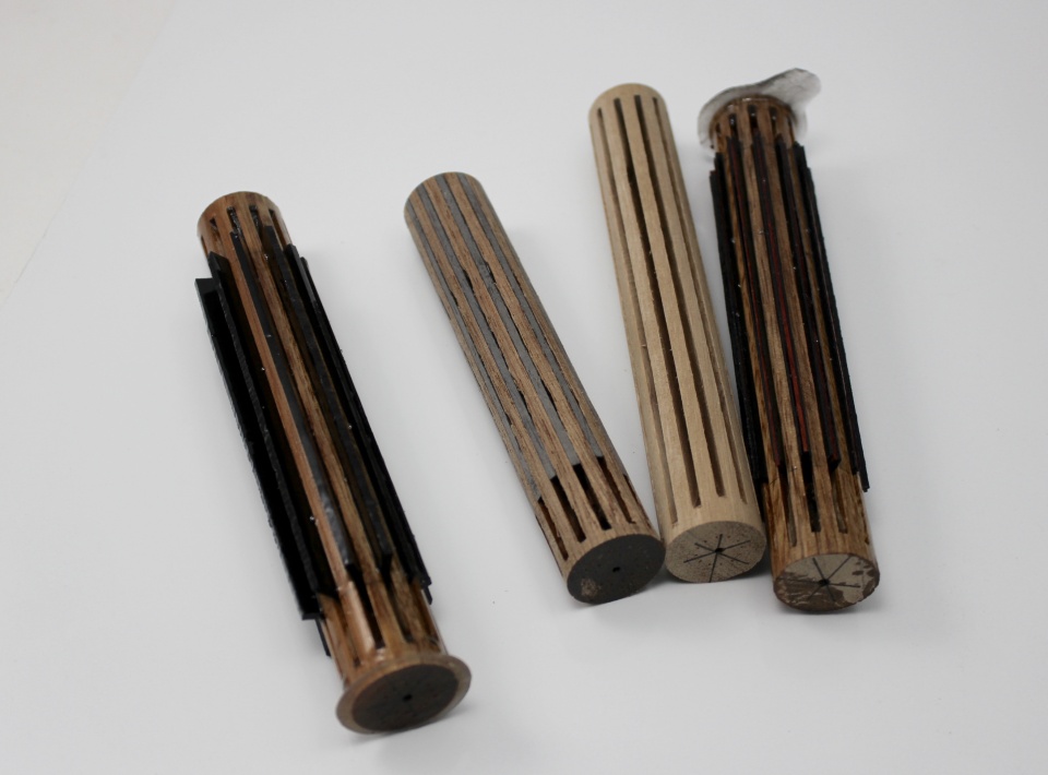

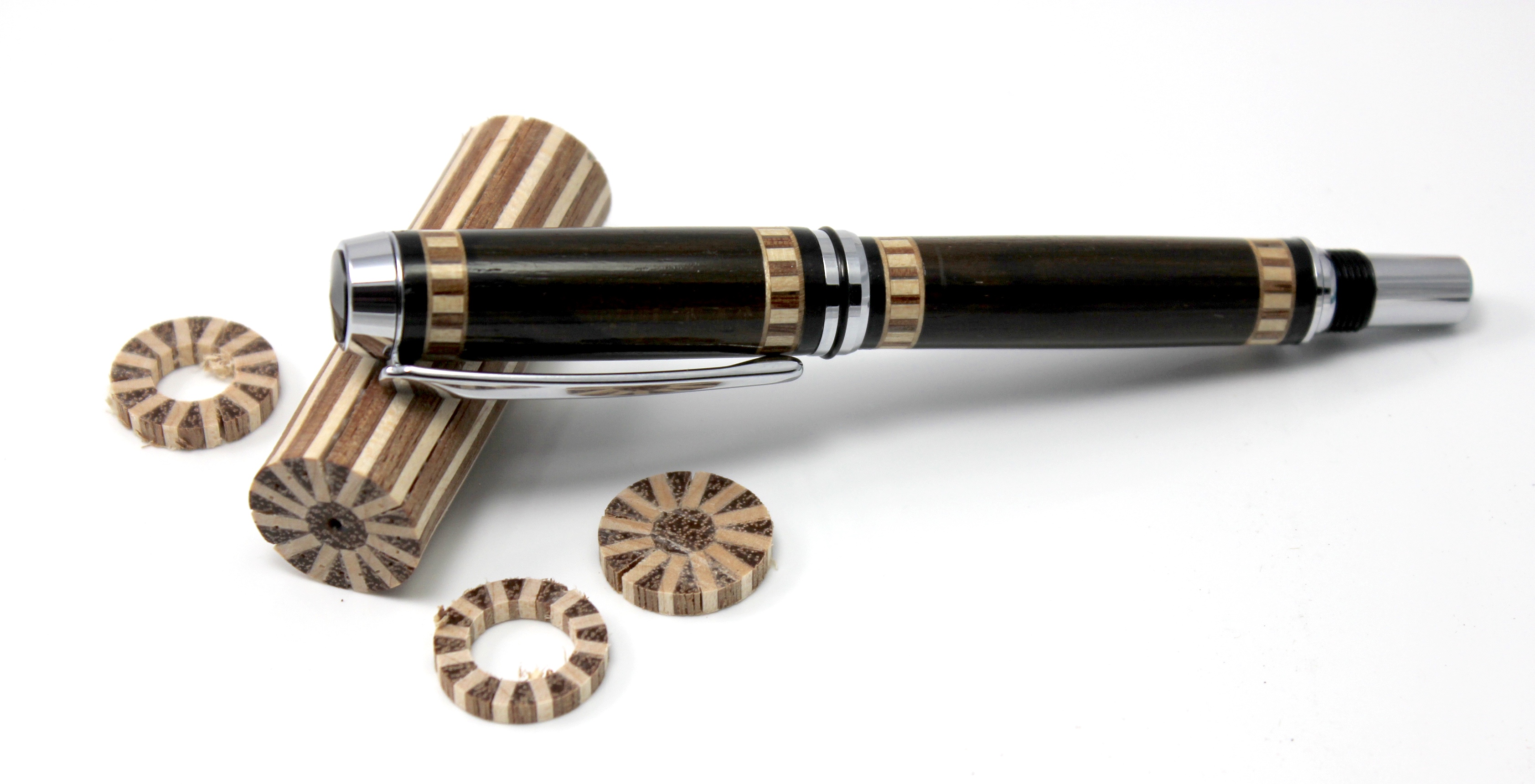

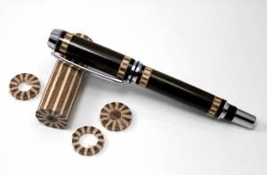

These are more of my glue-ups. As you can see, getting the inlays to fit also has a learning curve. The gray one I may not use, but the black one and the black-red-black look pretty good.
Hi Mark
Way cool looking pen , glade to see you getting it figured out .
I had faith in you .
You still need a metal lathe or the right cue lathe .
Double red veneers and Gaboon ebony .......

Since I bought the machine, I have switched the router from the front to the back side, and have re-tapped a bottom bracket (I am not sure of the terms for a metal lathe, but will take a picture). I have also modified a back plate to allow the slitting blade to have a larger cutting area.

I have a bunch of blanks cut (12 slot) so I will be playing with the veneers. I have assempled another pen and will post it as soon as I have time to take a picture. (I'll be at my Mom's for 4-5 hrs today), was at our in-laws all Saturday and Sunday. 86, 91 and 92... JT - You know exactly what we are going through with our parents. So this set of skills and techniques are a great source of relaxation.

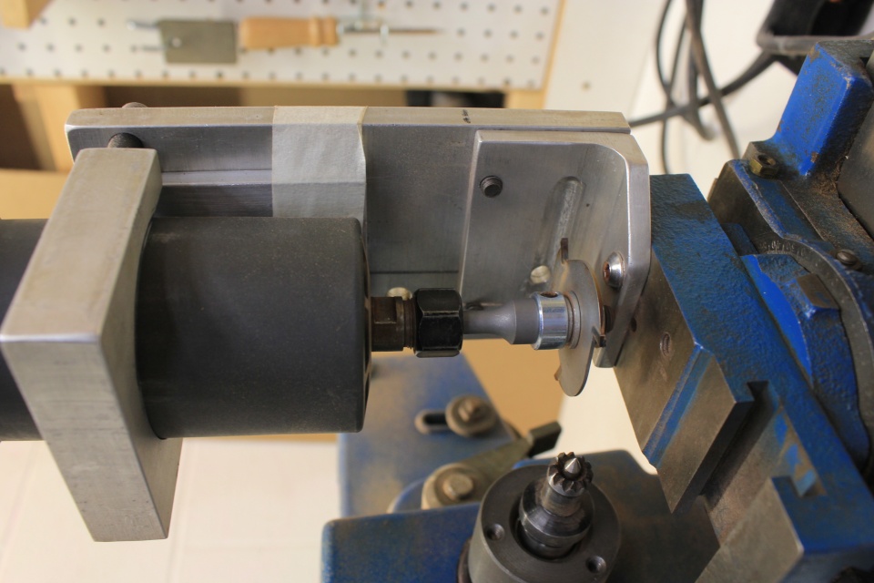

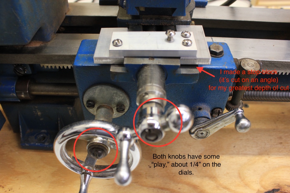

As indicated in the picture captions, two of my dials are sloppy. I have taken them apart, cleaned, etc, but I was not able to get them tight.
I also made a stop plate for the greatest depth I wanted my cut; this can be adjusted.
After I got the machine last summer, I tweaked the mounting plate, and reversed it from the front to the back of the lathe, and ground out more on the bottom section to allow more room for the slitting blades. I would like to simply redo the entire mounting bracket and use 4 screws instead of 2. While it is accurate now, I suspect it can be better.

Mounting bracket
Mark
I would like to see a better picture of you router mounting bracket .
I seen what I needed to see thank you for posting photos .
When you get ready I can tell you how to make pedals on your billet machine/lathe .
You will be cutting on top the wood .
Sloppy dials
Mark
Is the dials sloppy or the cross slide.
I put a dial indicator on my cross slide .........
Mark
Both dials are sloppy, the cross slide is very solid IMO. When I took it all apart to clean it and learn how it all fit, it had 2 white plastic shims to keep it tight. These went back in easily and I believe it is fine.
On the bottom dial, the slop is not an issue as it will not move on it's own.
On the top dial, I have to hold it against the stop block I made. When the router is on, the vibrations are enough to move the cross slide. For the first several pen blanks, I simply held the dial firmly, but I am more confident that the cuts are the same depth with the stop block.
I had the aluminum plates already, but I will eventually incorporate a dial indicator also.
