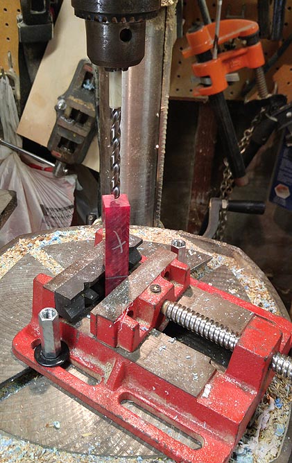

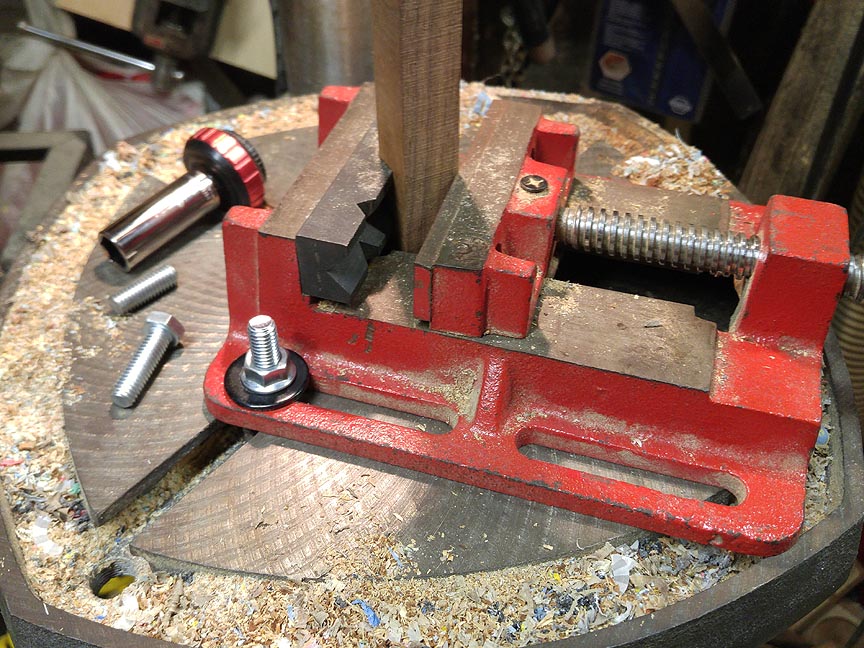

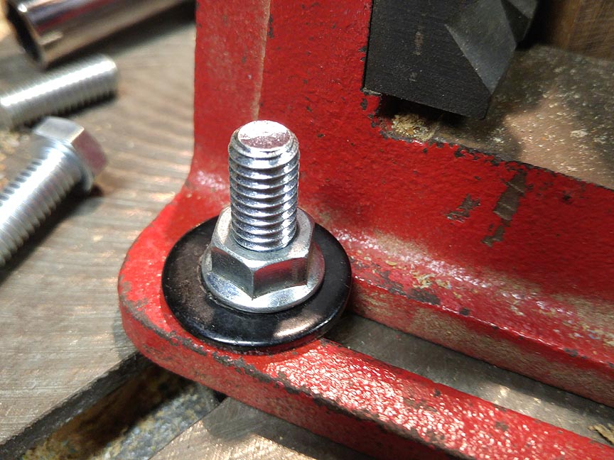

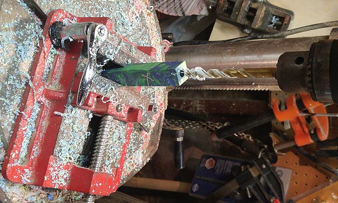

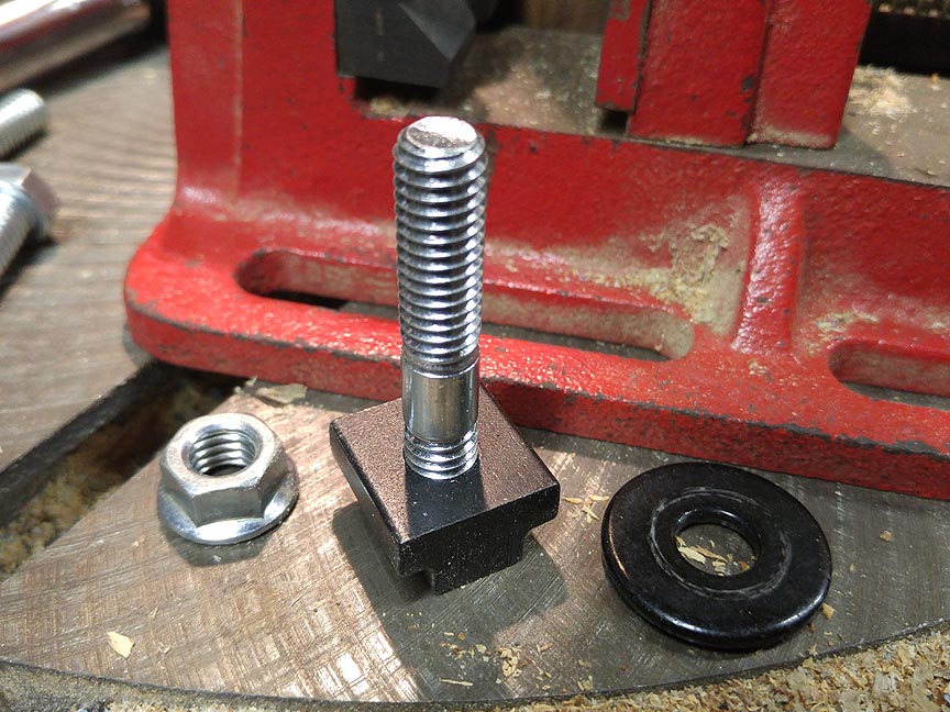

I've found for me, the times I've been lazy and didn't clamp the vise to the drill press table, there is a tendency for it to drill "wallowed" holes. Now I always clamp the vise. I recently got some t-nuts to use, since my drill press table has t-slots.
