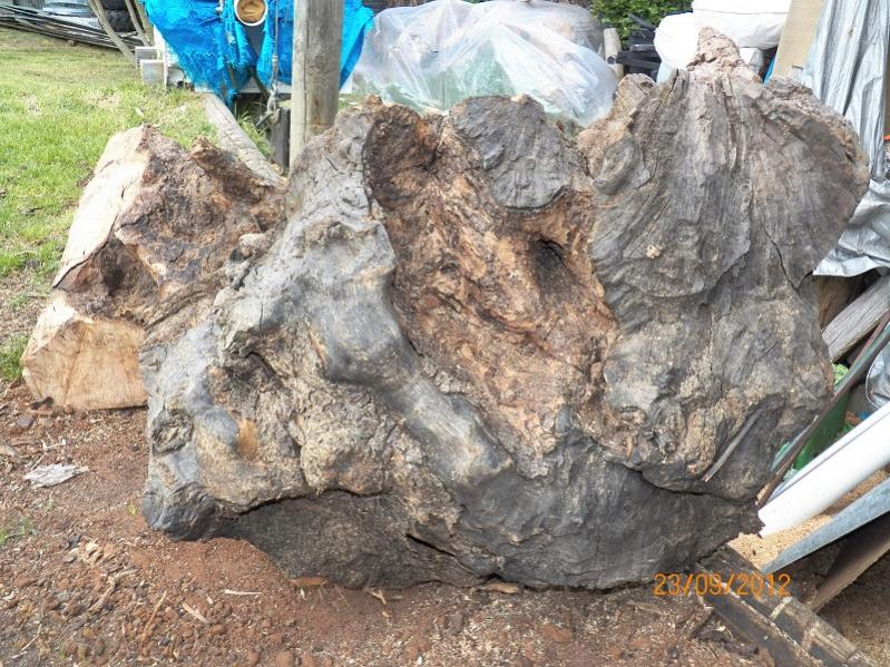

Would be nothing new for me to show here wood, any shorts sizes and shapes however, is not everyday that myself have this much Olive wood root semi-process for drying and further processing.
The pieces in the pics belong to a single humongous Olive tree root of 2 I have been processing, from a lot of 7 for 13 tonne (some of it is dirt, rocks, etc...!) I brought in to my storage paddock last year, as some may remember here.

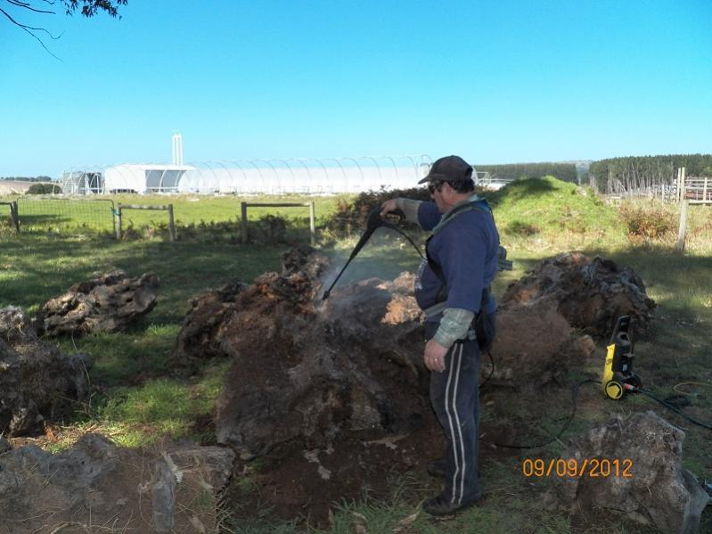

I've got 2 of the biggest ones washed and cut into "manageable" sizes (some still need 2 of us...!) but, being short of dry Olive root, I needed to get some done, as root will dry faster them the tree wood itself.

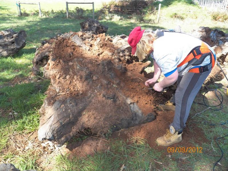

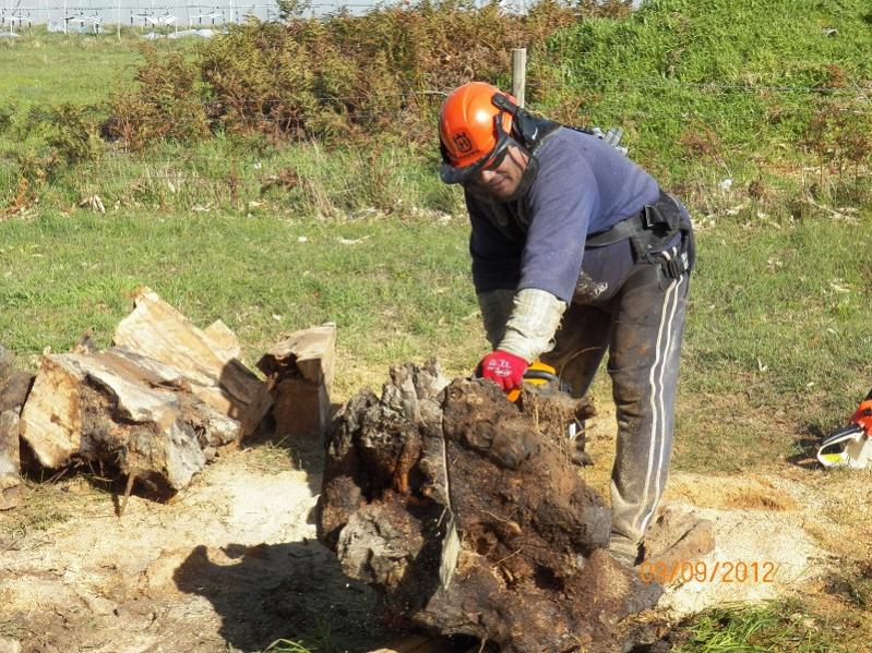

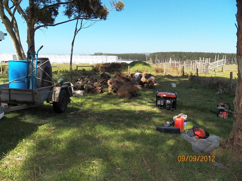

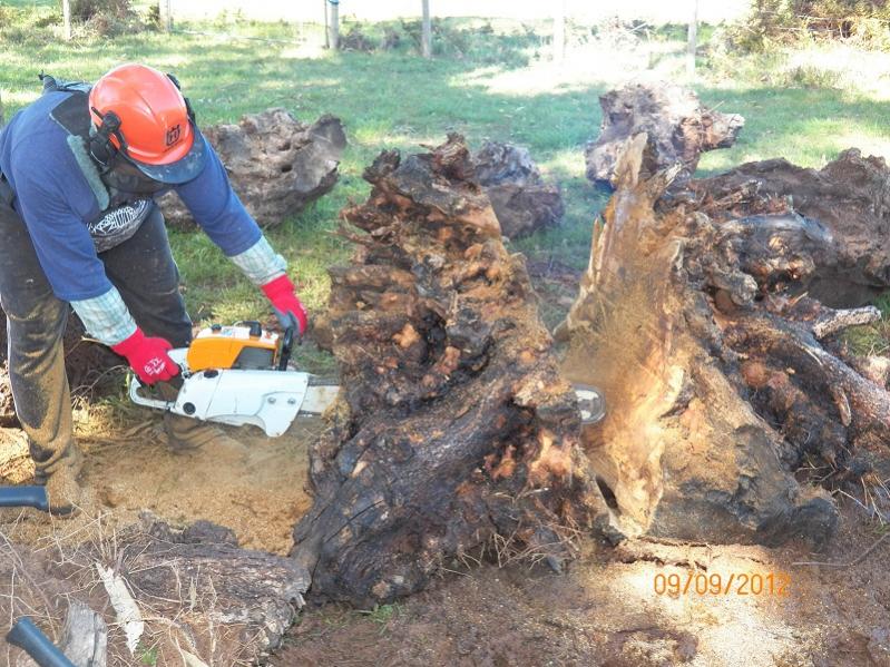

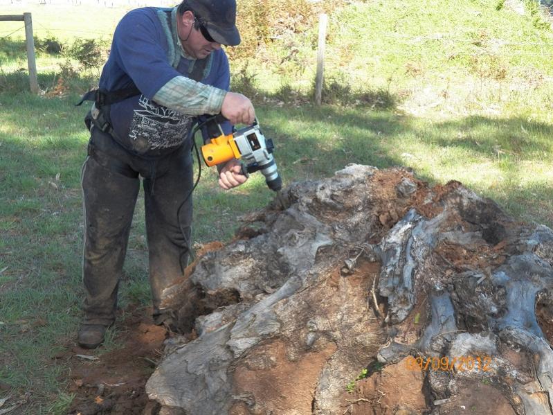

It all started 3 weeks ago, today (Sunday), one day at the paddock with all my "working team" and all the gear necessary to get this initial clean-up done so that I could put the big 36" chainsaw into work.

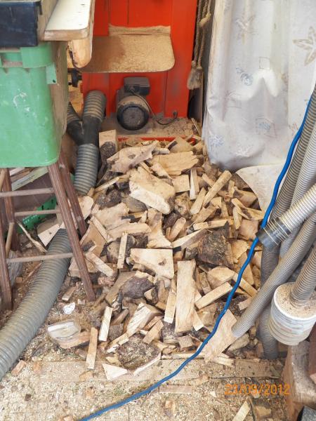

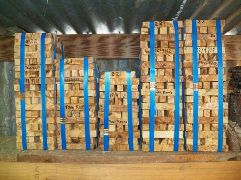

Since, I have been bringing the chunks home, give them another clean-up and then put them on the bandsaw for slicing. Most I want to cut in 2"1/2 to 3" thick slabs and stack them to dry while processing some smaller bits into square blocks or pen blanks, as I go.

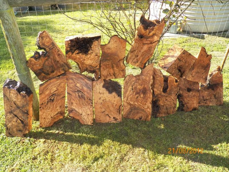

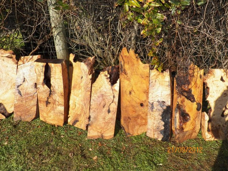

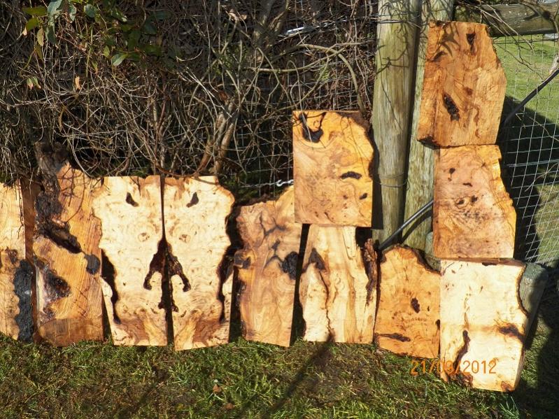

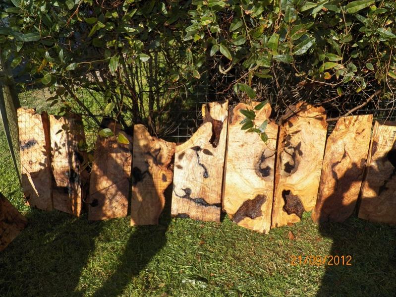

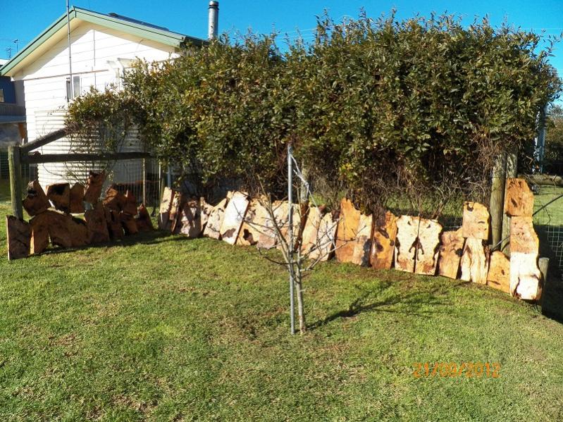

Last Friday, with a sunny day ahead, I decided to bring all the slabs I had cut and thrown on the floor everywhere, outside on the lawn, give them a spray with the garden hose and take some pics before I would start stacking them, on top of a pallet and under cover.
The slabs showing, are only from 1 (one) root, the other is still in chunks and waiting to be done in the same way but, that takes time as the pieces are heavy and slicing them, discovers more and more dirt pockets inside the wood that blunt my 1"TPI x 40mm x 2mm thick bandsaw blade far to fast, making me re-sharp it a few times daily...!

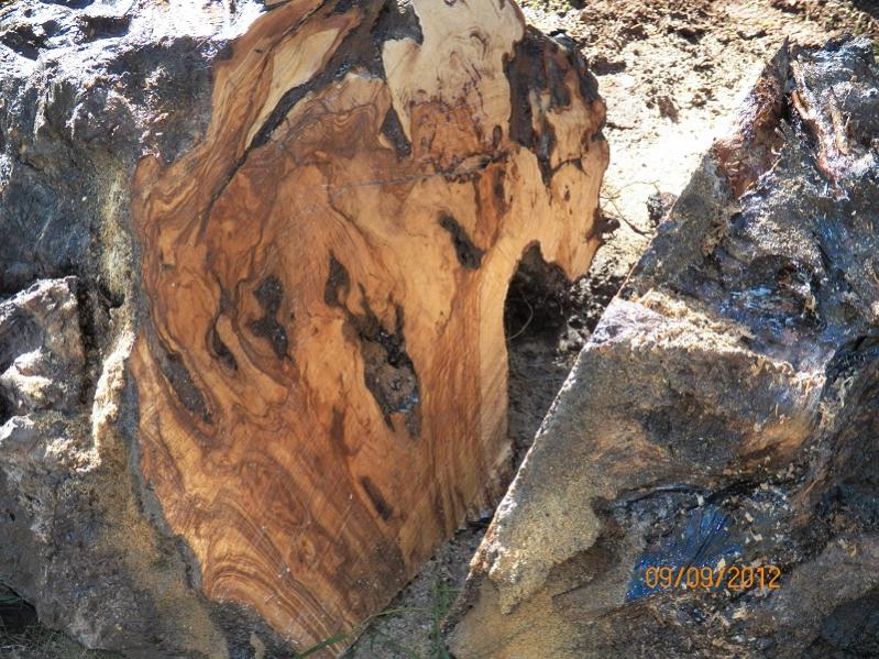

Anyway, I decided to start with the biggest roots (still one more large left) as they were the oldest ones 150 years + and the ones I was expecting/predicting/hopping/anticipating/wanting to find the best "treasures" inside but, these two roots have nothing special about them and a big disappointment, indeed.
The thing is, with Olive Trees, the roots can hold the most amazing and rare grains and formations, you will ever see, including pockets of blue stained wood (very rare) and some inner burls that are NOT visible from the outside. This nature doings, require a long time, therefore the oldest the tree, the higher the chances but, and like so many other things in life, what is suppose to be and or assumptions/speculations based on previous experiences, can prove to be a false lead and or results.
I have great expectations for the other roots I have still to process, why...? firstly because I know that, any of them is capable to provide me with the biggest and welcome surprise, "treasures" and *gems* grow in trees, which ones...??? that takes a lot of trial and error, hard work and lots of luck...!
The second reason I have high expectations for what is unprocessed in that, about a month ago, and due to be running out of dry root as mentioned previously, I was not yet ready to tackle the big stuff so, I went to the paddock and brought home the smallest piece I had there, the same piece that I almost left behind, as it was a small piece (about 20kg) that the bulldozer had snapped from a larger root, in the process of ripping them off the ground. This bit was full of mud and didn't look much, with a good chance of being only sapwood but, I decided to grab it by hand, while the large bob-cat was handling the other roots into the truck and trailer, I walked with it to the truck and throw it in.

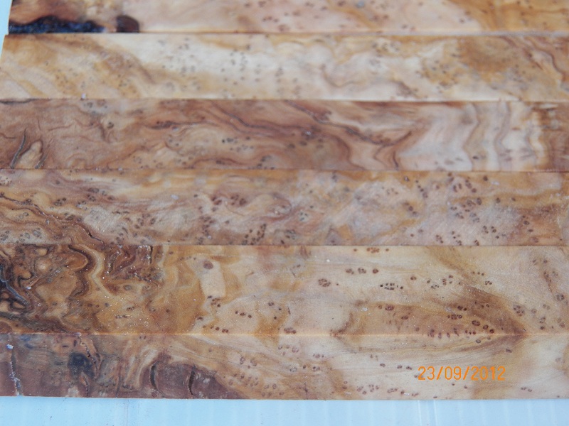

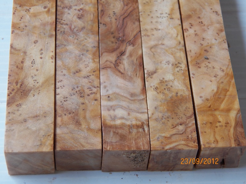

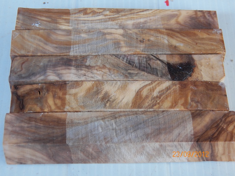

Well, it turned out that, that small piece that, even when washed didn't show anything special apart from that dark colour from the dirt stains but, when put in the bandsaw and sliced open, right through its centre, made my eyes nearly drop to my feet...!

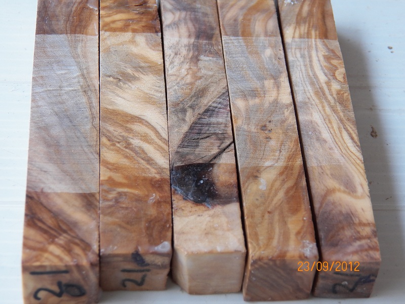

That thing was a chunk of blue stained Olive with a pocket of BURL inside it

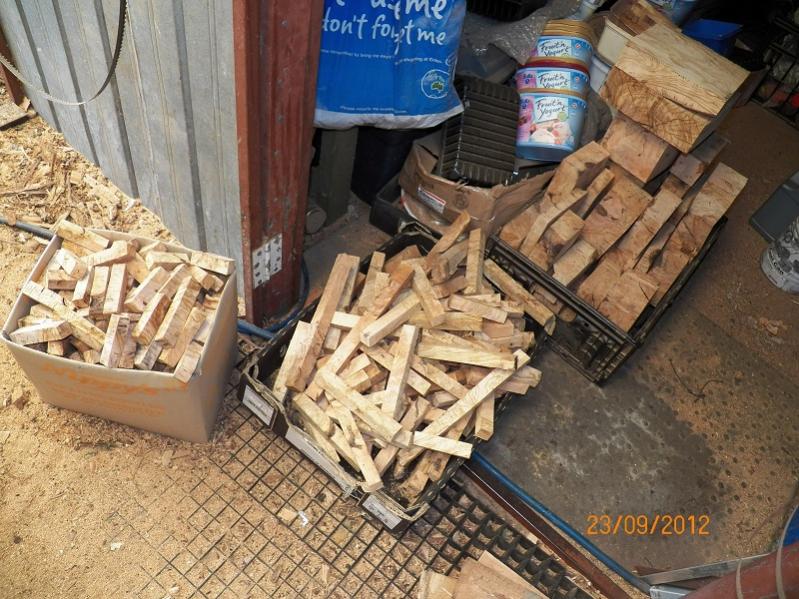

There was some sapwood around it that I cut off and then proceeded to slice it into 22mm boards from where I cut the pen blanks from. I was so excited that I never though in grabbing the camera, I wanted to slice it up and see how much good stuff I had in there. Another thing I now regret was not, at least, take some pics of each slab/slice before I cut it into pen blanks, loosing immediately (as it would be expected) its natural grain configuration and patterns, damn...! I endup with about 100 blue stained blanks and about 50 burl full blanks and some shorts, and that, I have pics of...!:wink::biggrin:
Now, that's what I would be expecting from the inside of those large roots but, that wasn't to be, unless those already processed and as I said before, I have great expectations on the rest, as that small root piece that gave me such treasures, belongs to one of the largest roots, the PROBLEM IS, when I went to load the roots into the truck, was a pile that we couldn't get close to, not only due to the "marks" put around it but also from clear warning from the construction manager where, he didn't wanted the bob-cat near that marked area, as the Power company has had just installed a under-ground cement box from the connection junction of the power lines to the construction site/new wine factory being built.
