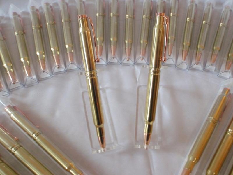

Just finished another batch of bullets. Getting tied of these about now, oh well it pays the bills. Sorry about the pictures gotta get them in the mail no time to set up photo tent.

Interesting twist on the usual shell casing pen!
Very Nice! Cah-Ching!! Congrat$ on the order!
Do you mind sharing your techniques to polish the casings?
Lenny I start by filing the larger scratches out then power sand with 220, 320,400 and 600 and then use the first 3 pads of MM . The bullet has the lead melted out and just polished with 0000 steel wool.
