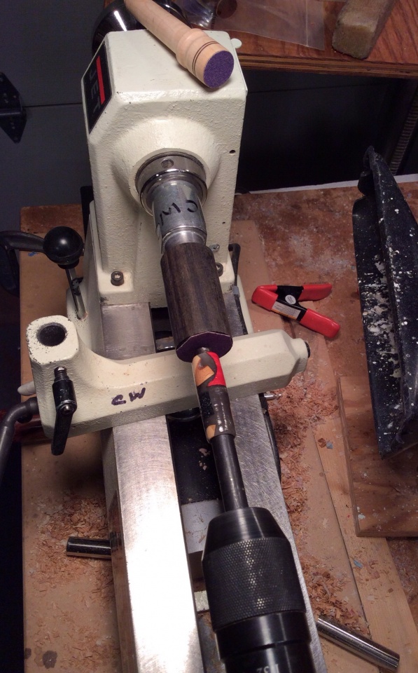

Dale,
Yes, a slight amount of ca does roll over the ends. The pic will show how I sand the ends to be square and flush. After sanding the ends, I seal the ends with some thin ca on a piece of paper towel. I want to seal the ends before going back on the tbc bushings. Sealing keeps water from wet sanding from getting in and showing up later and also, it makes the whitened end from sanding show more clear so you don't see this when the pen is done.
My first sanding jig is a bottle stopper on a screw on stopper mandrel. You can see I made another with a scrap of maple. #2 MT , double stick tape and some 100G sandpaper.
The barrel trimmer with sandpaper works too.
Here is the pic I forgot to insert.

Charlie, those look like very effective tools and would work well.
I too allow for a slight curve at the end of the blank.

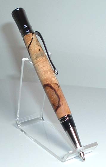

Here is the Executive pen I was working on during this adventure.
That is a piece of spalted pecan, not stabilized!
I think Ed was trying to challenge me with this one as that big knot in the side made turning it a bit of a pain.
I'll carry this one for a while and see how I like it.
Has a nice weight to it and a stout twist mech.
