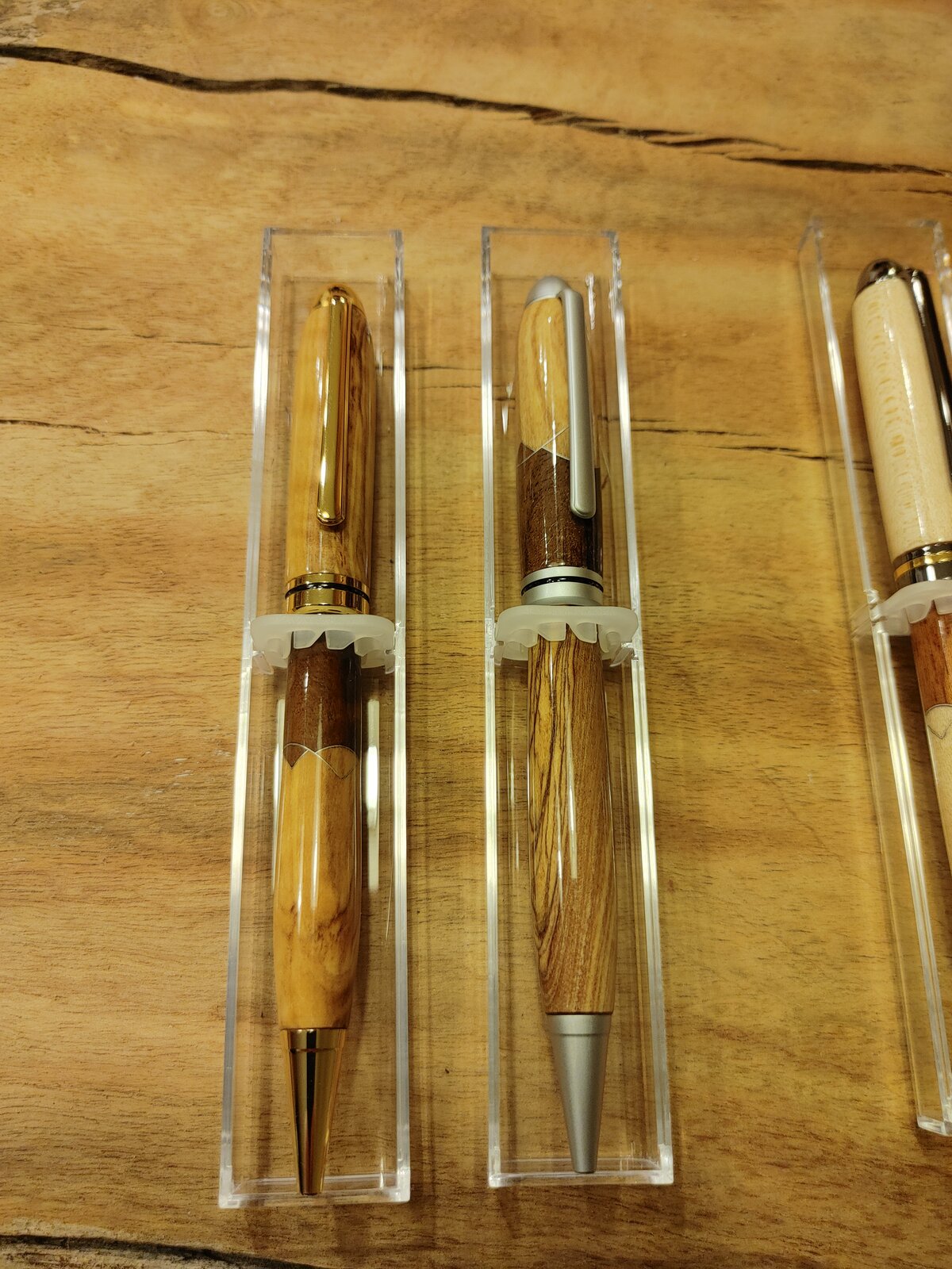

I have a barrel trimmer, but have stopped using it because of so many stories of them tearing up a blank (it also seemed kind of rough on the brass tubes). I have been using my disc / belt sander to square up and trim the blanks, and it has been working beautifully. Just use the miter square that comes with the disc sander (or in my case I just use a machinist square) and the disc makes short work of the material being trimmed. Quick, easy, and no issues with tear-out or otherwise damaging the blank. I just turned two pens using BOW this weekend and they both machined very nicely.
Just my $0.02 worth.
