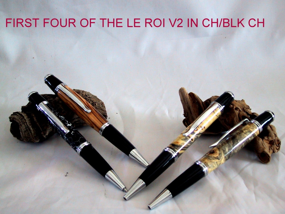

The Beta Test pens are proving Le Roi V2 should have a place in a lot of lineups. There is more "beef" on the barrel because we made for a 9.5mm (3/8th) barrel while keeping the component size the same. These pens show some pretty nice work. FOUR LE ROI V2 10-5-2000 4-54-10 AM.jpg

These are very attractive pens!
Question: when assembling the pen, does the chrome trim ring (between the barrel and nib) press-fit into the barrel? Or is it part of the nib section?
Thanks!

On this (Le Roi) style it is press fit into the barrel. That is probably true of other kits of the same style but I can't say for sure.
