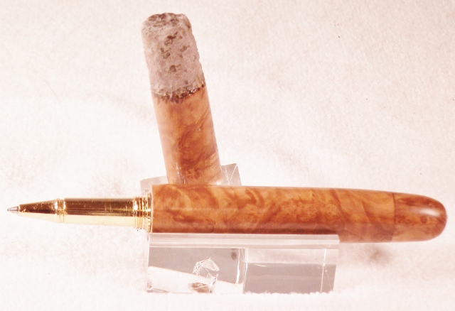

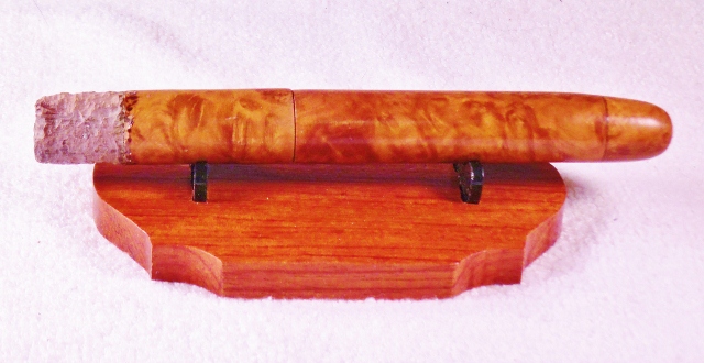

Mitch; That is the way I started with my first one. I went to the local cigar store and bought a real cigar. This gave me an idea as to the length, roundness, and color. I also looked online and bought some antique cigar bands. They are fun to make and if you display them on an ashtray with gray sawdust for the ash, you can fool most people. Cigar in photos was made from She Oak Burl. Jim S
