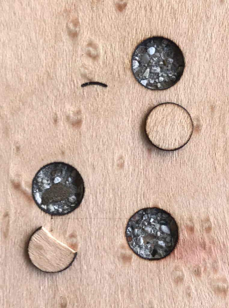

You caught me at a good time. Ive been burning through veneer testing an idea for finials. (1000mv)The hole on the top right is three burns at max. Lower left is with tape, three burns. No difference on the edge burning and it would have taken another burn to cut it through. It easily burns through the tape though and it could be very useful as a mask/resist.

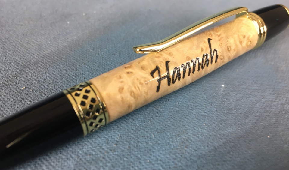

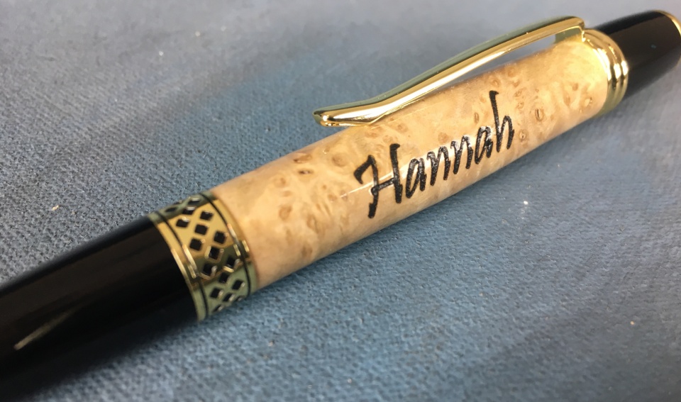

Big leaf maple works well
I have burned dark woods like cocobolo, bloodwood and darkened padauk successfully but the contrast is low. Maple like this big leaf maple, yellowheart, olive wood, apricot wood show high contrast.
