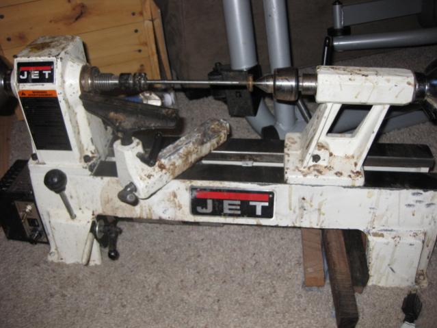

Today I purchased a used lathe (got a great deal) but the previous owner wasn't very careful about where his CA went a flinging....
is there a way to remove the CA so that this lathe won't be so ugly? :biggrin:
I'm thinking that there is something else on there other than CA, cause there's lots of brown "drips" all over it....
anyway, it's cosmetic, so if it doesn't come off, it's no big deal, but I'd love to clean it up if it won't kill me (time or patience-wise).
Thanks in advance for your suggestions.
Darci
Acetone will clean off the superglue, eventually, and will usually not bother the enamel finish. If it's on the ways a single edge razor blade will get most of it off. Sandpaper will finish cleaning it up, and a coat of car wax or floor wax, or even ren wax will keep it from rusting back up. Be sure to clean the bottom of the banjo and the tail stock. Roughing up the washers that hold them and the bottom rails between the ways will help it lock up nice and tight.
thanks James. I was mainly worried that acetone would damage the enamel, but I'll try it out and see! Now, where to get acetone by the gallon?! (kidding.)
here's a photo of my ugly lathe. :tongue:

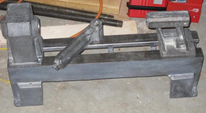

in progress
Here is a photo of the "restoration" in progress. It's been an interesting event.
it's a nekkid lathe.:tongue:
we ordered, and already received, new bearings for it. Oh, and we ordered new JET labels/plaques. It's going to be practically "new" when we are finished!

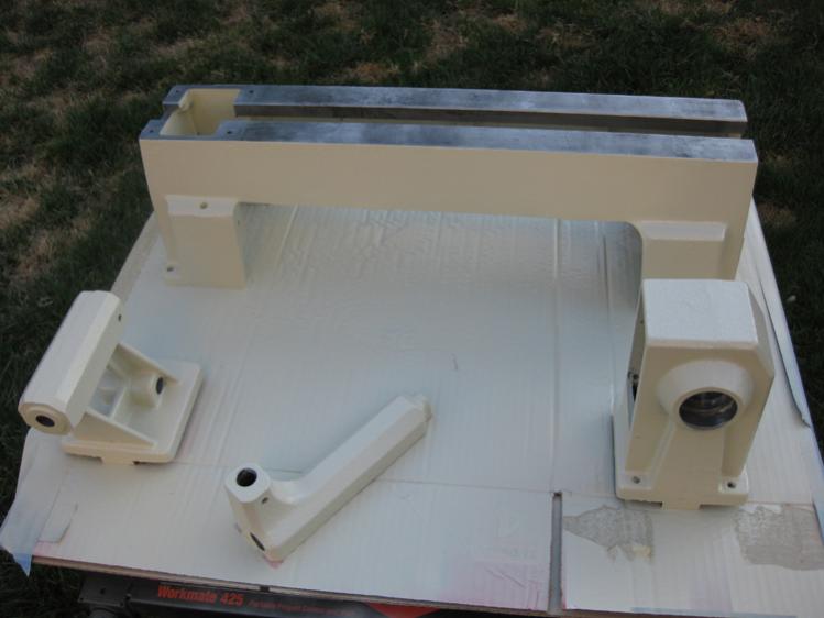

next job: selecting the paint (Hubby wants to stick with something close to the "original" color), then PAINTING. :biggrin:

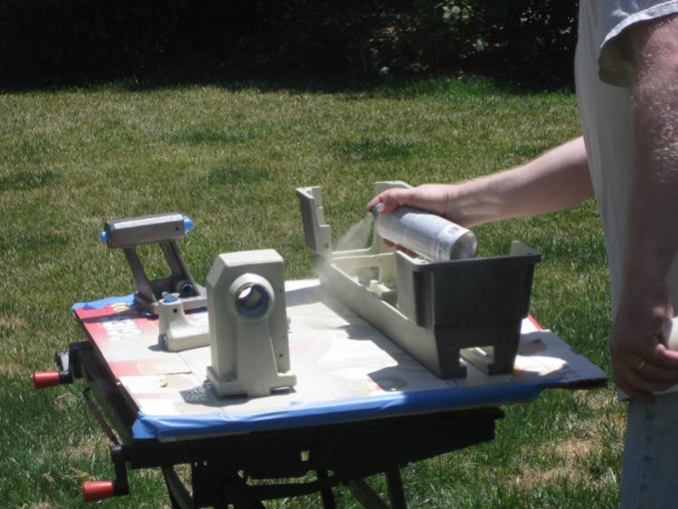

Here are pictures of the new paint job, although it is still in progress.
We used Almond appliance paint, and got a near perfect match to the original JET color.
We need to put another coat on to cover some places where we missed... but the instructions say "reapply within 30 minutes or after 1 week." Of course, we didn't realize there were missed spots until it had been 2 hours since the last coat.
new JET labels will be here at the end of the week.
