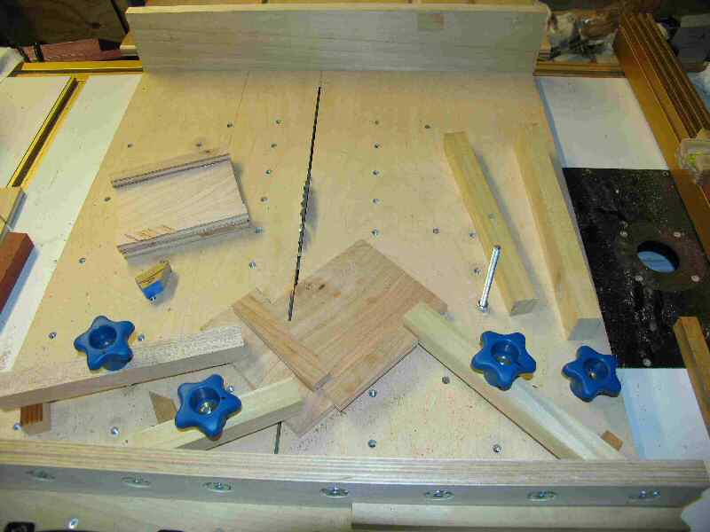

I guarantee that even with a $4000 cabinet saw, if you're using it to do a lot of segmenting, you're gonna want to build a nice sled anyways, which will cost some money and/or time.
Karl; This is my table saw sled. You can just see in the bottom of the photo the two door handles. Guess where my hands (and fingers) are when making a cut?
