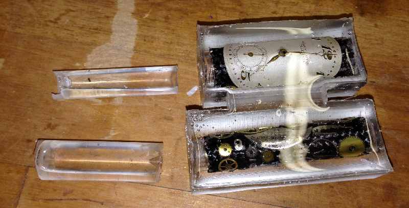

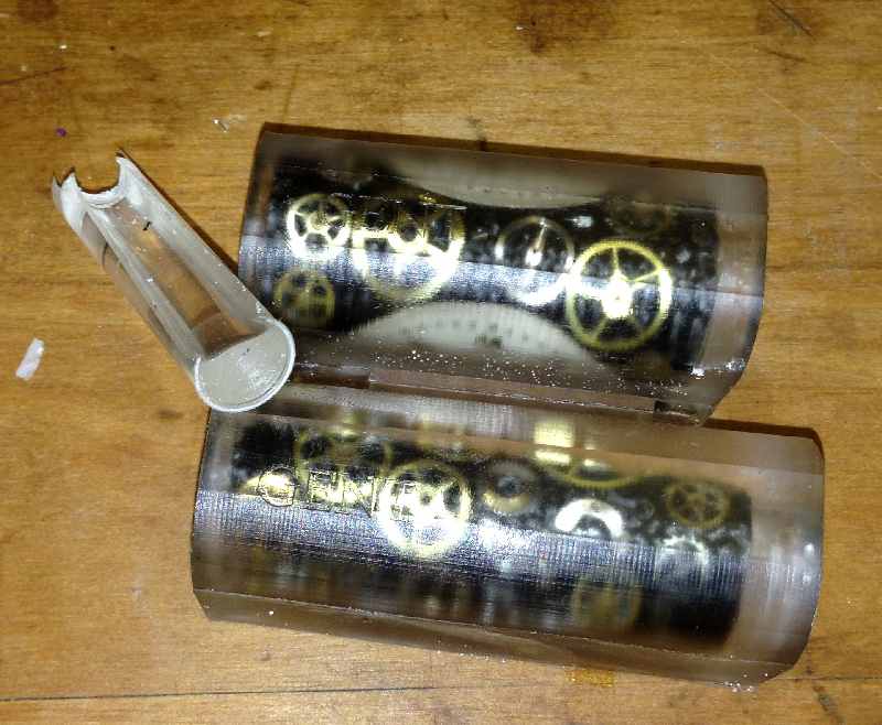

Best way to clean out tubes that leaked UPDATED
Well when I got home tonight I decided to try and drill out the tubes. I got out the Drill Doctor and sharpend up some bits. I decided to go with the biggest bits that I have that would fit the ID of the tube. Because there wasn't a good flat surface that was perpendicular to the tube I decided to just hold the blank. I set the drill on the slowest speed and pushed the blank up into the bit.
The pen gods must have been looking down on me because as soon as I put pressure on it the plug popped out. I thought it was fluke until I did the second and the third. All 5 of the plugs popped out without cutting a single chip. The only thing that I can think of is that once the Alumilite cured it shrunk just enough to make it easy for the plug to slid out.
Thanks for all the suggestions.
Mike
