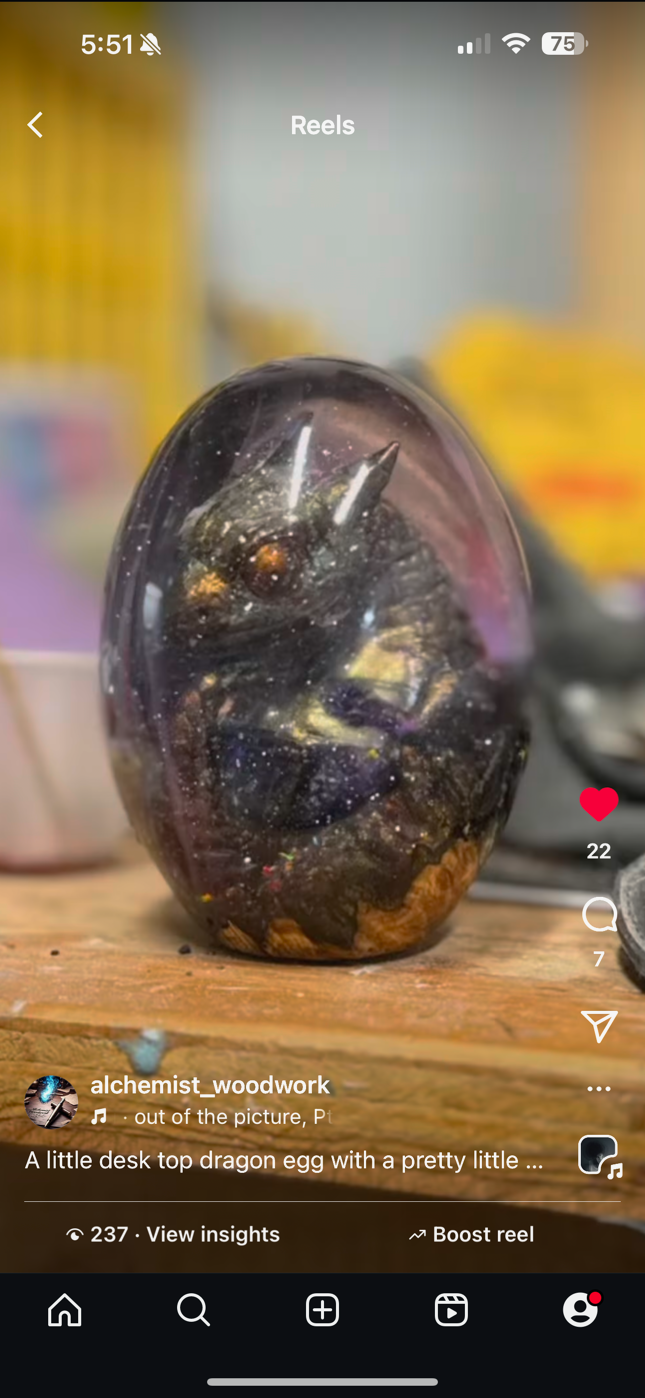

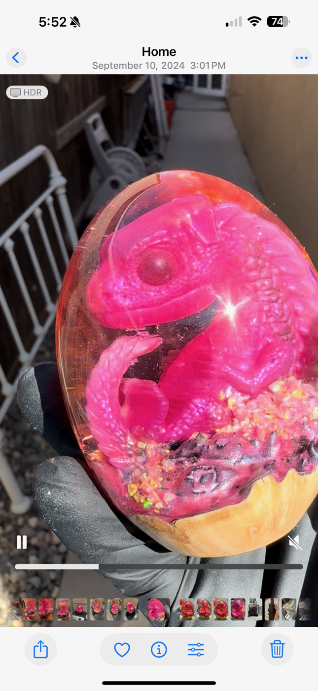

You can not vacuum chamber clear or clear slow. Here is an example:
A pair of dragon eggs.

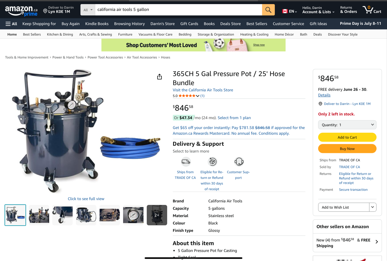

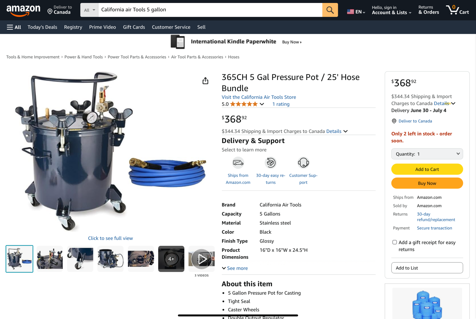

So, California Air Tools, cancelled my order, they don't ship to Canada and, after processing my credit card, they tell me they were also out of stock too.
Off to William Woodrite, after the money has been returned to my credit card, which will be within 2-7 business days according to California Air Tools.
So, California Air Tools is guilty of having a misleading website , designed to get interest free loans from unsuspecting people in other countries ! They know VERY WELL that they have a Canadian distributor , possibly exclusive , who I think currently have the 2.5 gal pot in stock . My advice Scott is to take the temporary hit to your credit card and get it now , before the retaliatory tariffs begin .
Don't know if Amazon ships to Canada or not, but they do carry them.
William WoodWrite does carry them. Unfortunately it looks like they are out of stock of the 5 gal. But the girls there are great. Give them a shout and they can probably tell you when they will be in.
interesting, yes, not the same make... but they have them, and for much less.... Thanks!
Keep in mind. While a 5gal tank would be awesome, I and many others have been successfully using a 10L (2.5gal) for years.
It just so happens that KBC Tools, out west, has the 10L California tools on sale right now.
My guess is the tariffs are why California air is not shipping to Canada. It also may be why WoodWrite only has the 2.5gal and the 5gal is out of stock. Can't get more in.
