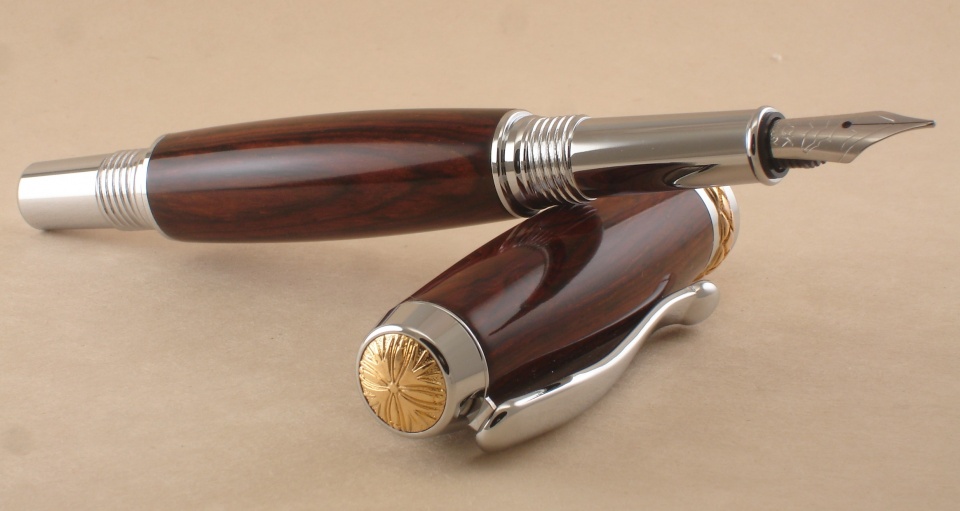

After reading Les Elms' dipping method tutorial I decided to try it for myself. I have been using a different product than Les and I'm still trying to perfect the application process but I'm getting closer. This is a Cocobolo Triton that I completed last year.
Bill
