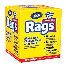

I get the Scott Box of Rags from Sam's Club. I cut them into strips and fold them over to make a pad for application. It works very well for me.
