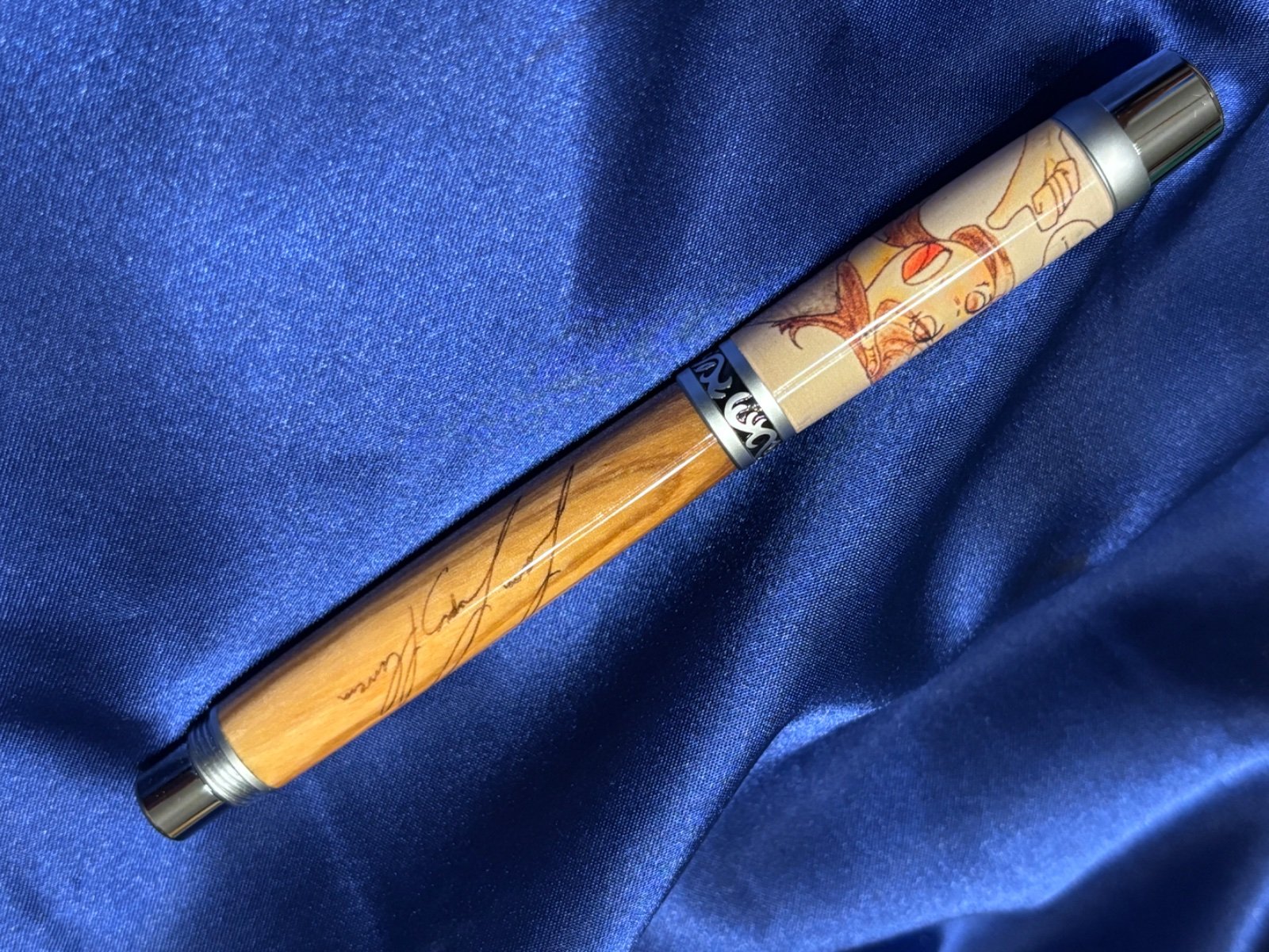

There's been several threads on this subject. I'll add some photos of what I've used. You mentioned the way the edges matched up. Are you using a butt joint for the seam? I always overlap the seam. That way I don't have to worry about an exact fit and having problems if it's not perfect. What I do is paint the tube white since that's the color of the label. That way the brass won't have a chance to show through or dull the label. Then I'll put a coat of Elmers over the paint. The label seems to stick better IMHO. Print the image and let the ink dry. Then I'll put a light coat of clear over the image to seal the ink. Stick the label on the tube and put a light coat of Elmers to seal the label to the tube. That way the seam won't want to try to lift. I use Alumilite Clear slow to cast the blank. I've been really pleased with the results. Good luck.
