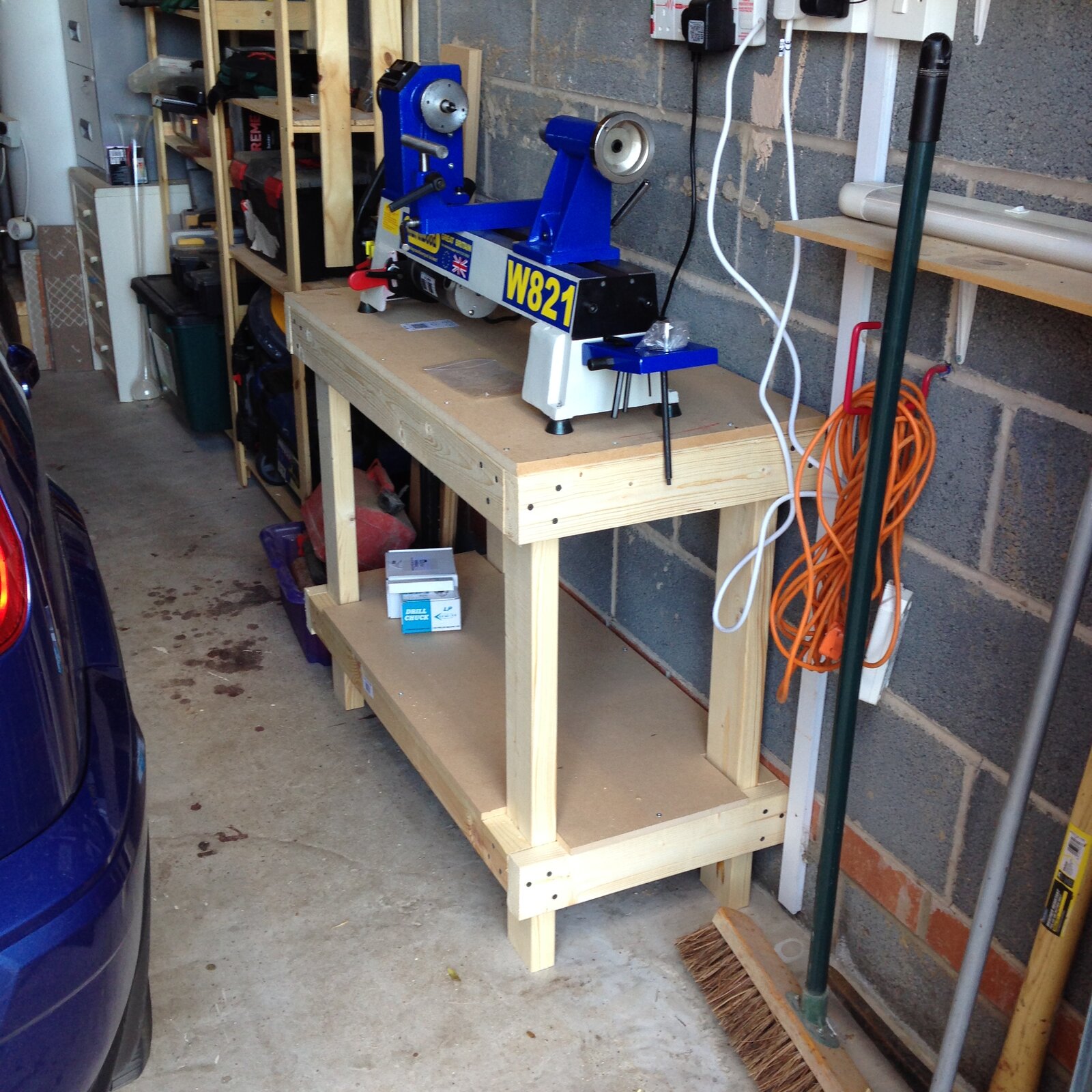

I built my own bench to fit in a space in 2015 and it's still as sturdy as ever
Timber frame with mdf for the lower shelf with cut out corners to fit onto the frame and screwed into place
You can turn the top over or remove and replace the top easily and cheaply when necessary
I found plans on the internet
I have separate drawers but they could be easily incorporated in your bench to fit the dimensions
Best wishes for your project
You will get a lot of pleasure by making it yourself

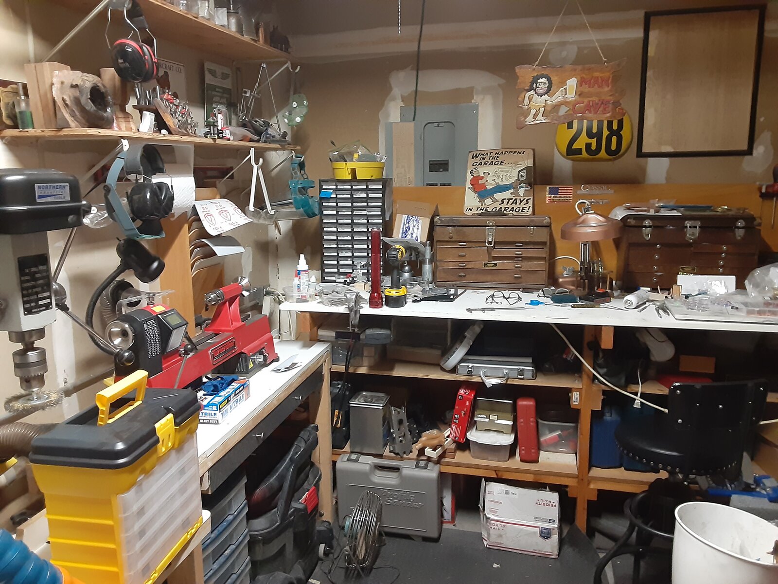

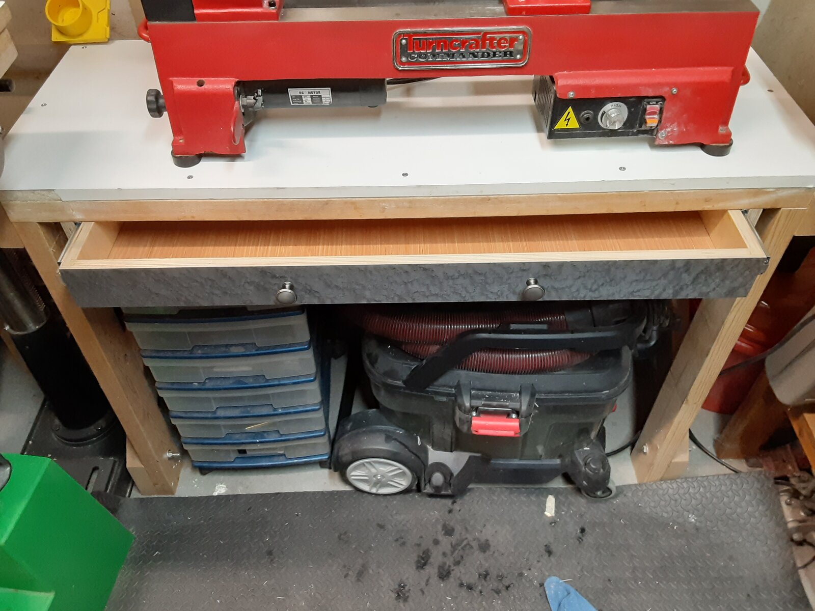

My bench is made from bolted up 2x6, 2x4 and MDF layers from a Woodsmith plan. I added some rows of 2x4 to one side to make it easier to put a vice and tail vise on it. I was not sure about the MDF when I started but it has been fantastic. I have a bunch of coats of minwax poly on it. It's held up really well although pretty much due for a refresh on the poly. this is an ancient photo of the shop, it looks different now that I have cabinets and other stuff in it. Table has stayed in that spot though.
I would not use MDF as fronts for drawers but that's probably just a personal thing on my part.
