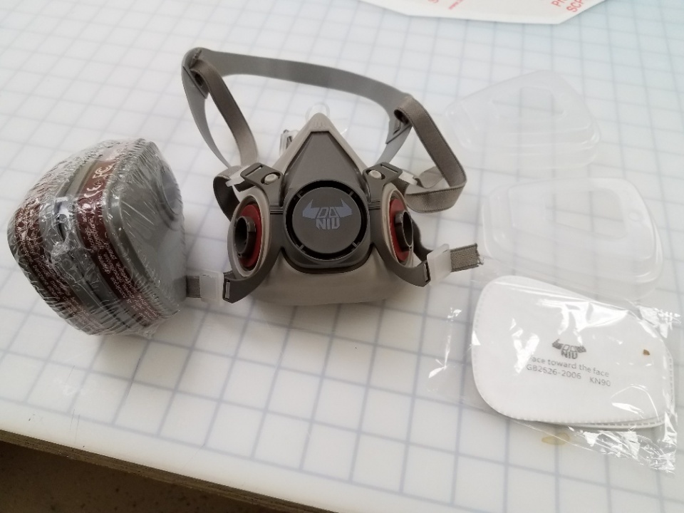

Ok I got a 3M "clone" from my favorite Chinese direct place that sent it to me in 4 days from their NJ warehouse.
They are 6001CN main cartridges with the extra dust filters.
Just needs a slight mod. I need to direct the exhaust down to keep my face shield clear.
