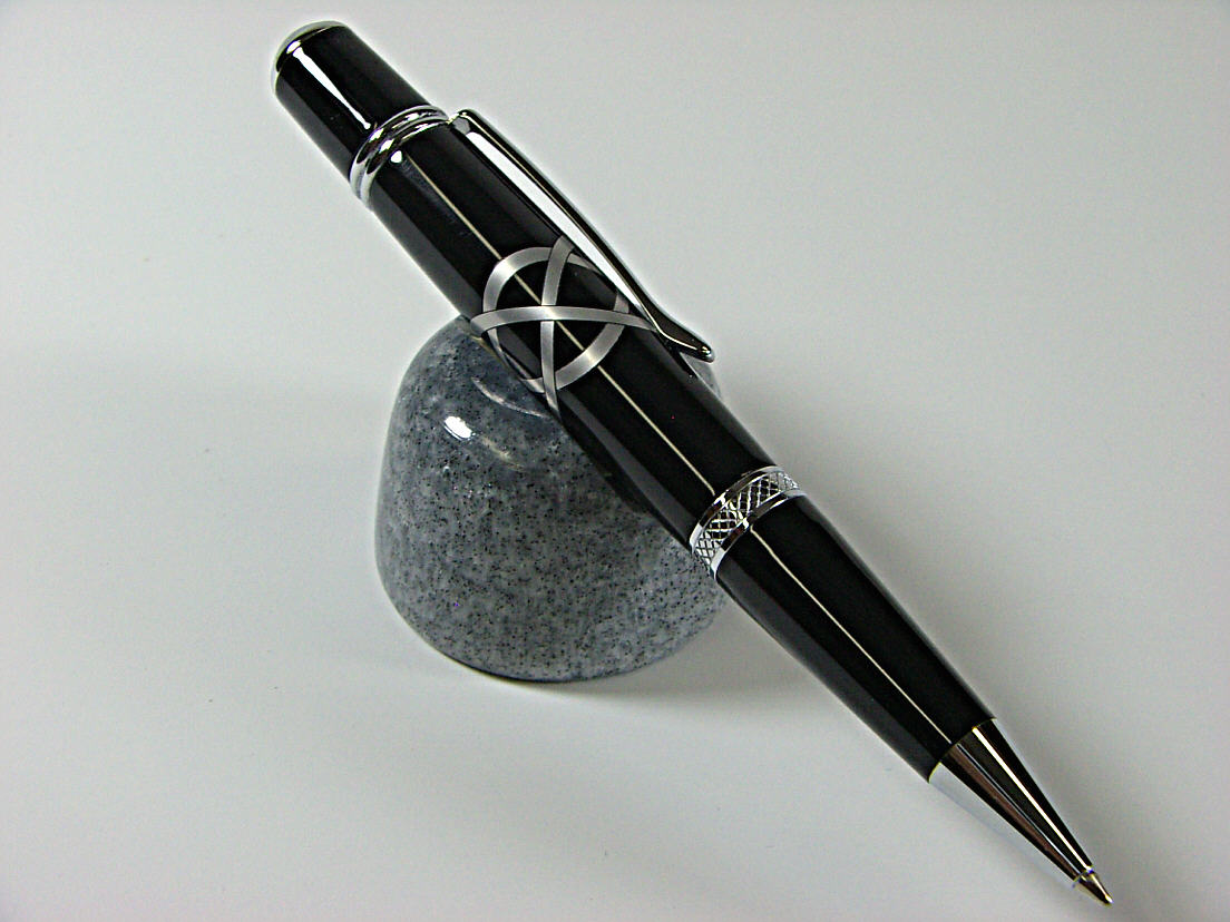

@jttheclockman you posted a Celtic knot pen somewhere on here with tinted epoxy and I loved the faint black border it gave. Going to have to try that on my next segmenting project.
Thanks everyone, I have quite a few piano keys so I'll give both methods a try.
Here you go. Black acrylic and aluminum and epoxy System3 T88 glue with system 3 black epoxy dye.
