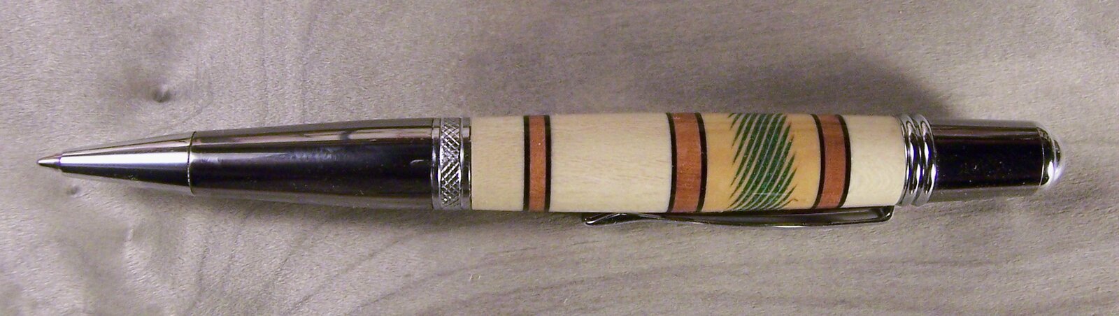

This one does not seem bad because of the crisp engraving. The filler is a finely ground malachite powder, from Arizona Silhouette if I recall correctly, but could have been many others:

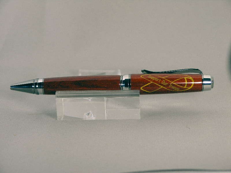

I generally go with 2 layers of thin CA, burn, clean the burned area off with a toothbrush and alcohol. Use acrylic paint to fill and immediatly wipe off excess, give it time to dry then sand any leftover off with 600 grit then complete my CA finish. I only have a 1 Watt NEJE box unit but for pens and small wood medalions I put in the bottom of bowls that I make it works well. Sample shown is using a piece of blood wood I had.
