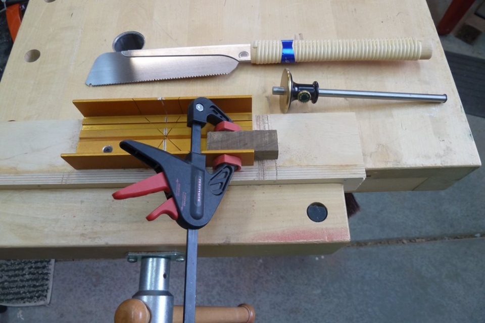

Thanks for the responses. I guess I'm going to do what I've done in the past. It seems that's what gives me the best and easiest results. The tools I use, I've had for years. I use the opposite end of the line scribe as a depth gauge since it fits into the tube. I leave 1/16th to 1/8th and square the rest on my HF 10" disk sander. Here's a pic of the tools:

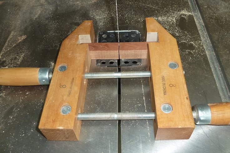

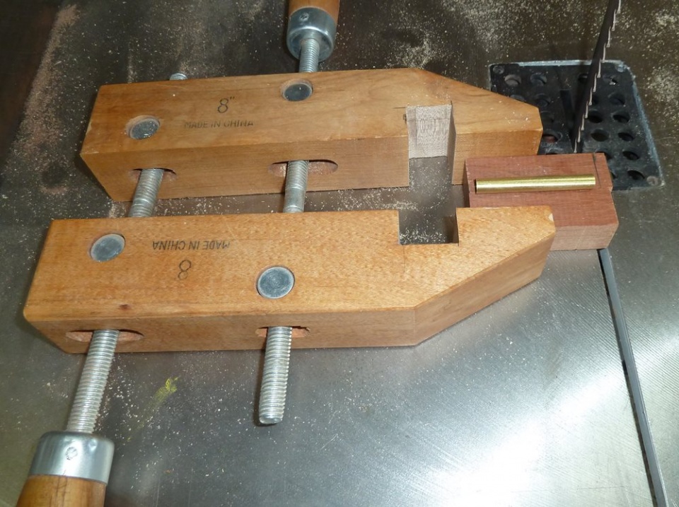

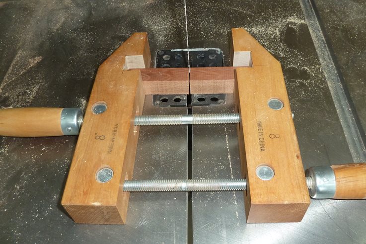

I've been cutting by hand but now I started using my bandsaw. I guess I didn't before because I thought I might want to change from the resaw blade. I just take it slow and easy and concentrate on the line. This makes sense for me and will make the trimming much easier. Here's 2 pics:

It makes sense, but I use an insertion tool. I drill the blank holes, put the tubes on the insertion tool, put the glue on the tube, and put the tube into the blank and twist it around. I was using the PSI blank cutter, but I'm going back to a pen mill. Not sure if I'll use the drill press, hand drill, or the tail stock. Guess I'll just try em all and see which I like best.
I realize now that I have been making my blanks too thick which left stock on the sides after using with the pen mill. I have been following the instructions that come with the various pen kits for the blanks and I've found that those are always too thick or too long. However, if I buy precut blanks from CSUSA or PSI, their blanks are always 3/4". I make all of my own blanks now though so I can blame myself if they are not dimensioned right. :)
