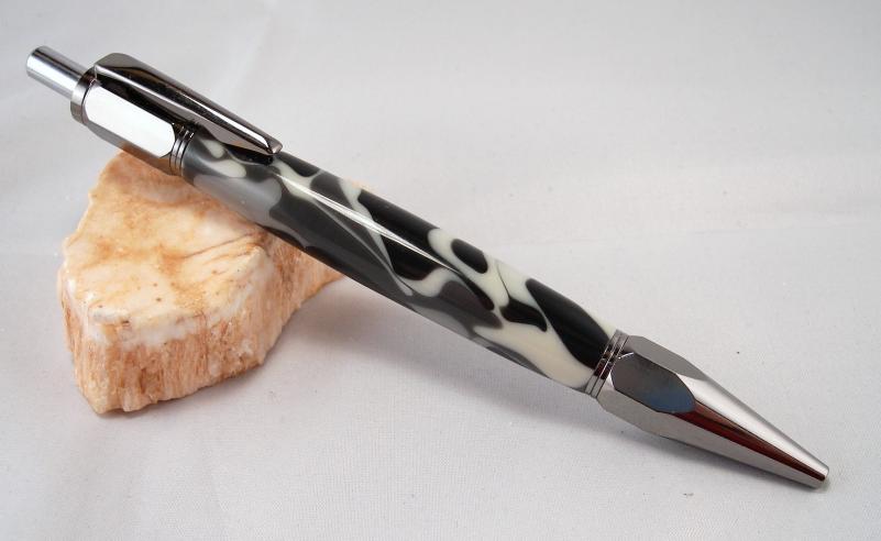

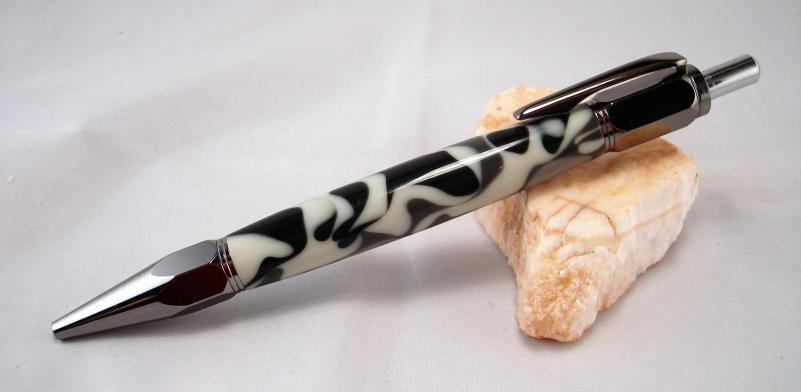

I have to agree with a lot of the folks who favor the Vertex. I have never had a problem with a faulty click mechanism, nor have my customers after the sale. I can also attest to the issue about the cap snapping off if dropped. Usually for me, the plated cap and its internal plastic threaded core are the parts that break away from the main assembly. I have repaired two of them that this occurred to with other click mechanisms. Other than looking oddball because of the longer length of the button, the mechanism still functioned with no problem. Unlike other mechanisms, I am unaware of a source to get replacement click sections for the Vertex, short of buying another complete kit. This particular Vertex was my last repair; you will quickly note that the button cap is chrome vs the gunmetal finish of the pen. Other than that, it is a daily-use pen for me. Ironically, only about 1 in 5 folks even notice the finish color difference.
