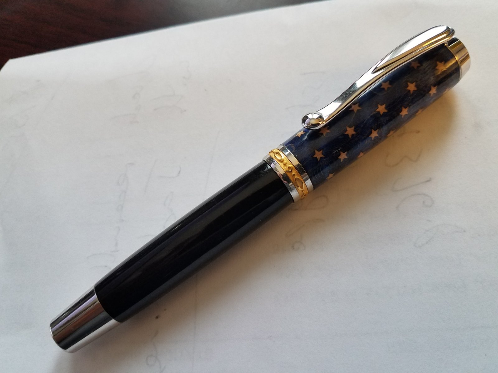

It depends what you are using it for. Personally I only finish pens with CA. Never use it to stick tubes in. For finishing my favorite is GluBoost. I apply 3 - 4 layers of thin then 3-4 of medium.
