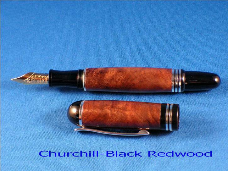

I have been using a CA finish topped off with a friction lacquer (commercial version...I got it from PSI). It puts an extra gloss on, and seems to give a very hard, durable finish. I rarely have a problem with the CA setting too quickly. I spread the thick version on one of the blank sections, run the lathe on slow speed, and wipe it across both sections with a small cloth pad. About two strokes is all you get before it sets and grabs the cloth. I leave the lathe running on slow, and spray it with accelerant. Then wipe again with a cloth pad, spin it up to high speed, sand it with 600 grit, use 3EEE, and micro polish from there up to 12,000. Then I put the lacquer on...one layer, burn it in good, buff it with a rag, and I'm done. From untouched blank to finished pen takes about 3/4 of an hour for decent, saleable finish. Obviously blanks with defects that need to be filled or fixed take longer, and I do blow a few up, so my average on the big pens is closer to an hour (except today when cleaning up the shop was the only thing I didn't screw up)!
Here's an example:
