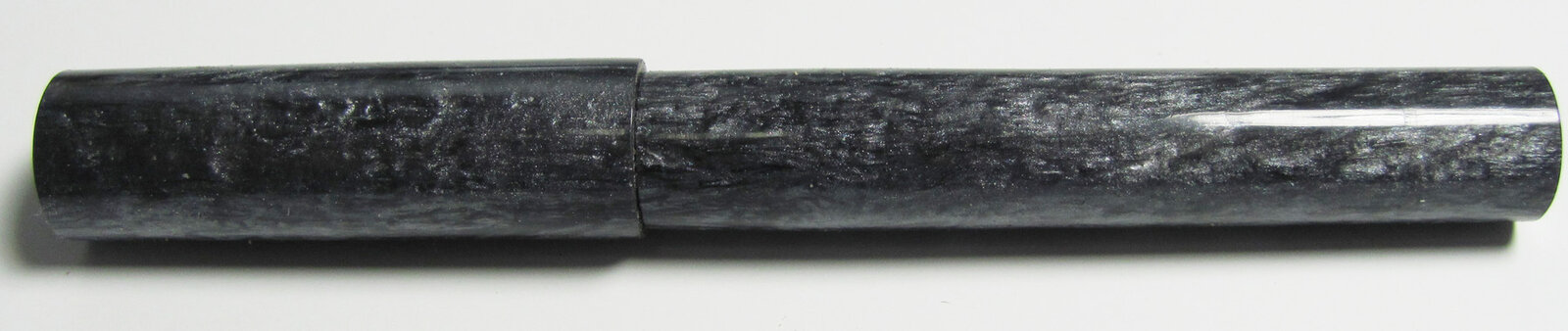

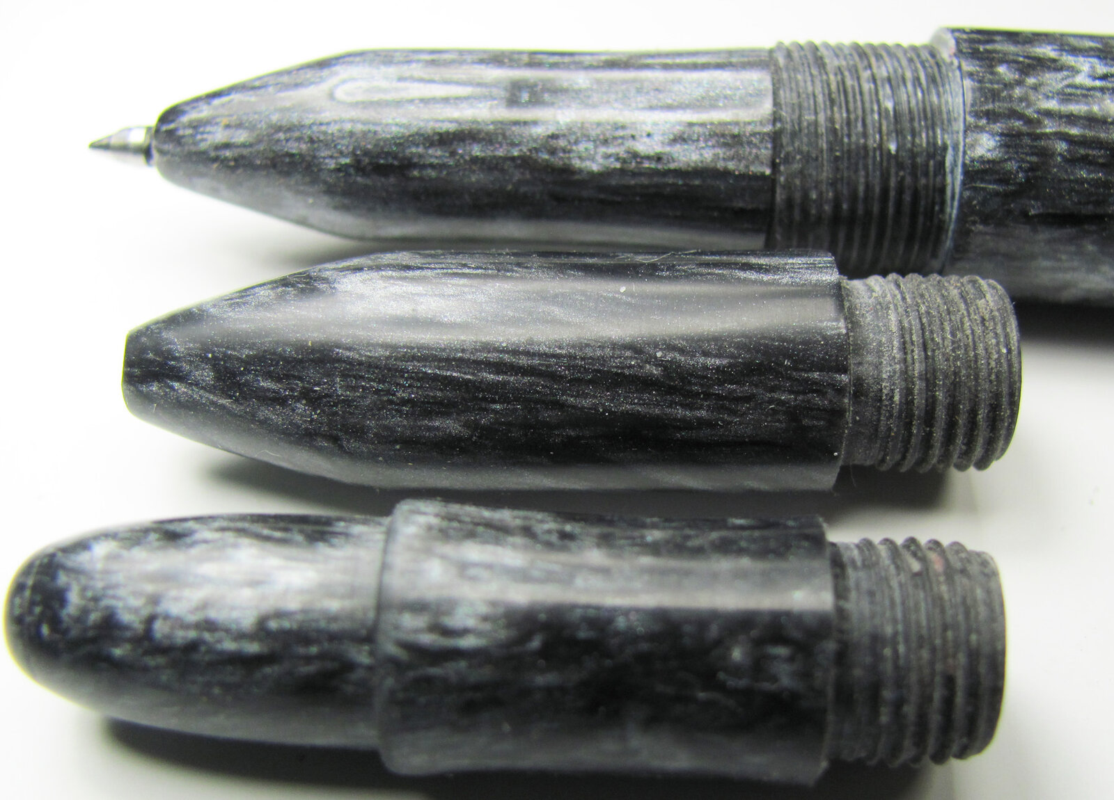

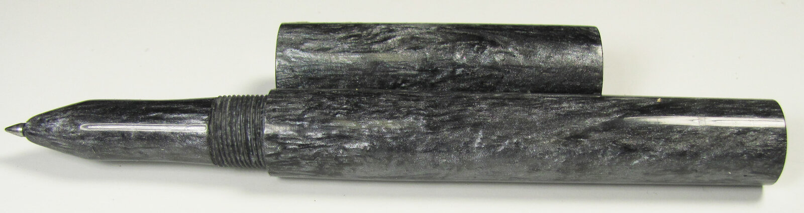

This one truly is a bespoke pen since it is made to order and not made for maybe a sale later. My customer wanted a rollerball and no clip. The blank is Alumilite Clear Slow with Caster's Choice Mica powder: Pewter. The rollerball is a little more unforgiving than making a fountain pen. The drill in the barrel has to be spot on for the rollerball refill to work properly. The section has to be drilled and counter drilled with 3 drill bits and has to be the correct length for the refill to protrude properly. The section took a few tries to get it right. Enjoy and comments welcome. One picture has the section I like better and two others that I rejected.

Very nice! You don't use a spring at the back end of the body? I thought these would make it easier to adjust the length requirements.
I agree with the section choice. Of the other options, one looks a bit bulky, and the other like a.... an acorn😅
Thanks. I did use the spring because I drilled just a radio too deep. This is my first rollerball. I learned a lot. Will be making more.

The section/nosecone is quite the challenge, for both the styling and practical aspects.
