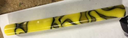

I'm one of those types that often just goes my own way.
My first pen was kitless. I almost went down the path of making pens using kits and all the accouterments that go with kit pens (mandrels, pen kits, glue, etc).
But I watched some videos and did some research and decided to just make a kitless.
This was my 1st attempt:
I even made my own custom mandrels out of aluminum.
So, it's possible to jump right into kitless making. I made my first one with just a metal lathe, a digital caliper, two tap/die sets from amazon (not triple threaded), some drill bits, the custom mandrel I made, some sand paper and polish.
I haven't made a lot of progress over the last year, between selling my house and health issues 2020 sucked. But I hope to get back into things right after I move in Feb/March.
